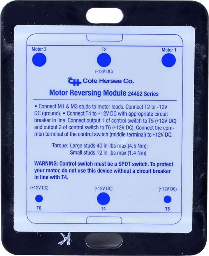

[QUOTE=PA.WOODCHUCK;4739509]Google this, it handles the ram load amps and the up/down switch controls this relay. slow ram issue solved!
Easy install and neat
Cole Hersee 24452
This relay system will work with the way the double pole switch on the dash currently operates the hatch motor?
Did you just spice this relay system into the system this shortening the power supply to the actuator or did you also increase wire size too? What size did you use?
Appreciate the information,
Chris

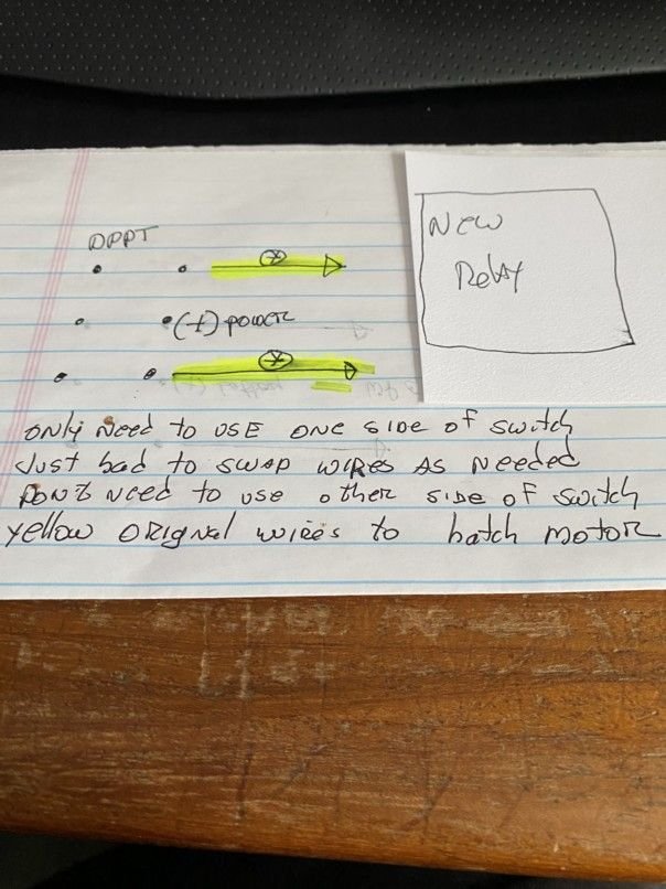

PA.WOODCHUCK 05-23-2020 05:08 PM
I used 12ga wire for powering the replay, your wiring from the switch is OK since it only operats the relay now. If need explanation PM with your phone number. I used a 20amp circuit breaker but mine only draws 10amp running the hatch up.
https://cimg6.ibsrv.net/gimg/www.off...1256441ce8.jpg
https://cimg7.ibsrv.net/gimg/www.off...e747c5fb5e.jpg
https://cimg2.ibsrv.net/gimg/www.off...35c4b32c7.jpeg
easy to follow on back of relay

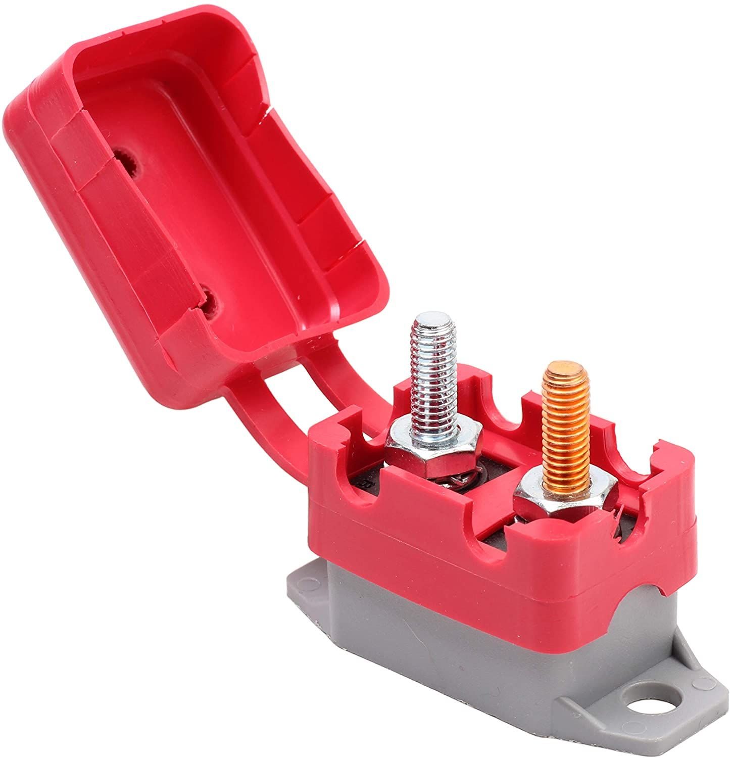

Last follow up item. I used a self reset 20A circuit breaker.
https://cimg7.ibsrv.net/gimg/www.off...4d2a72af67.jpg
liberator221 06-08-2020 07:26 AM
Just did in line fuse on mine, wish I had found a breaker like that. Very clean looking.
Keith 06-08-2020 07:58 AM
Two previous boats I owned had this type of breaker which resets if it trips. So I decided to go that route on the Formula.
