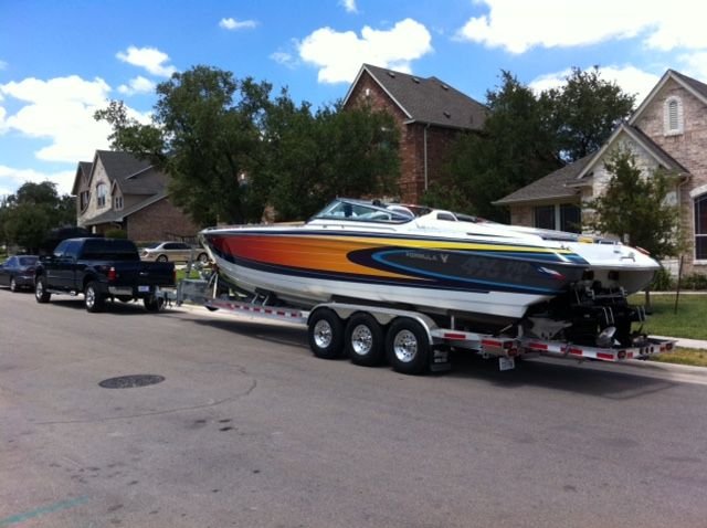

You will enjoy the step up to a 353! It is a solid platform that will serve you well. The cabin is large enough to accommodate week end overnighting and the cockpit is large enough to accommodate 6 people. If you plan to do any trailer boating, the 353 coupled behind a proper towing vehicle will be just under the typical truck and trailer legal length limit of 65 feet in most of our states. A longer boat would typically require an over length permit for highway movement. We have a solid history with Formula fastech models starting in 1995 with a new 292 fastech,. In 2000 we grew to a new 312 fastech. Our last move was a new 2006 353 fastech with 496HO's. The 353 hull has been our favorite. Our tow vehicle of choice has been a Ford super duty F350 (one ton).
353 with Acceleration graphics
Beautiful bird! I'll most likely go Ford since everyone i know with a 6.7 loves them.
