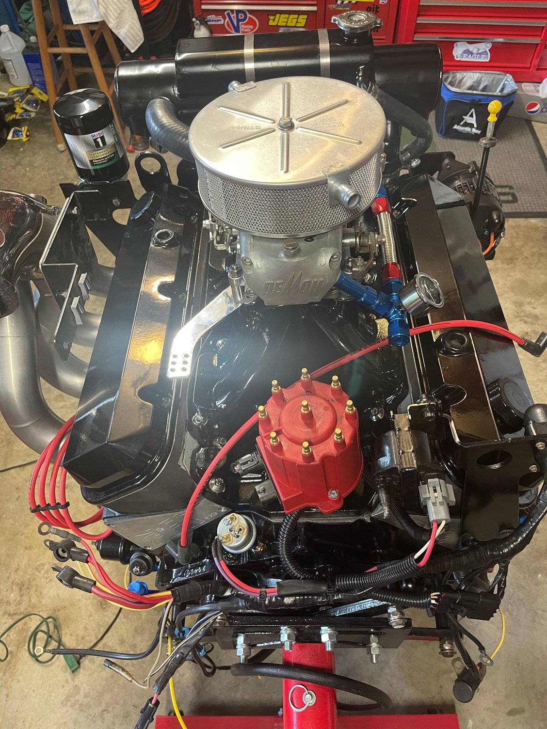

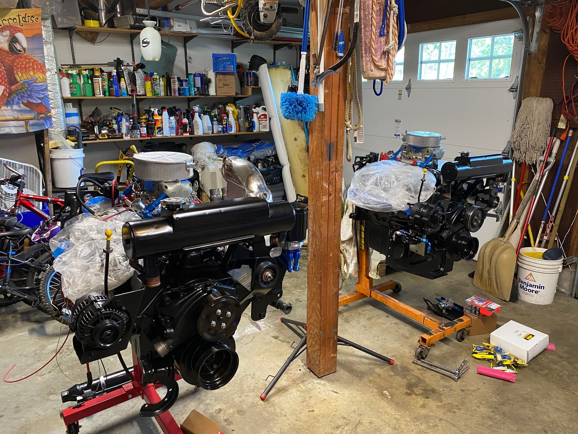

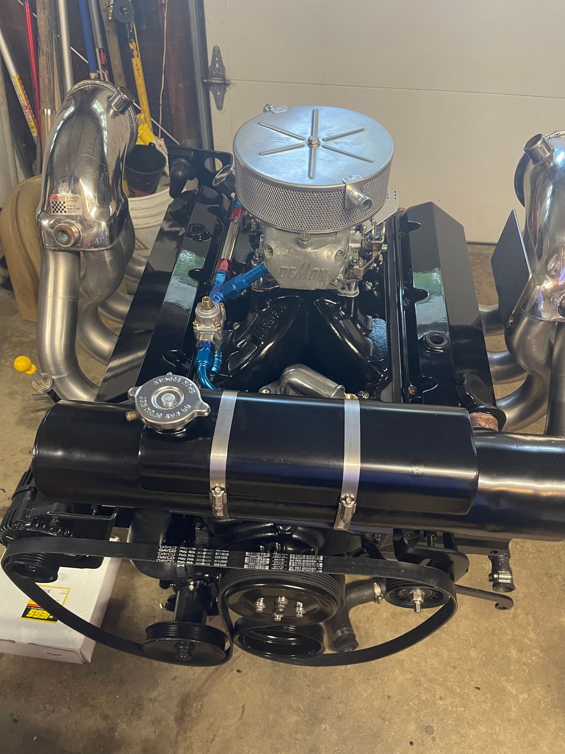

Making progress!
I’m at the point where I can set the engines down on their mounts and bolt on the flywheel cover to get the final oiling, cooling, and fuel lines run.
https://cimg6.ibsrv.net/gimg/www.off...e4e3df917.jpeg
Port
https://cimg9.ibsrv.net/gimg/www.off...e8a39082d.jpeg
Starboard
https://cimg8.ibsrv.net/gimg/www.off...c7ec54c54.jpeg
And the pair.
I’m glad the iron heads are gone... the stands are a little unhappy!

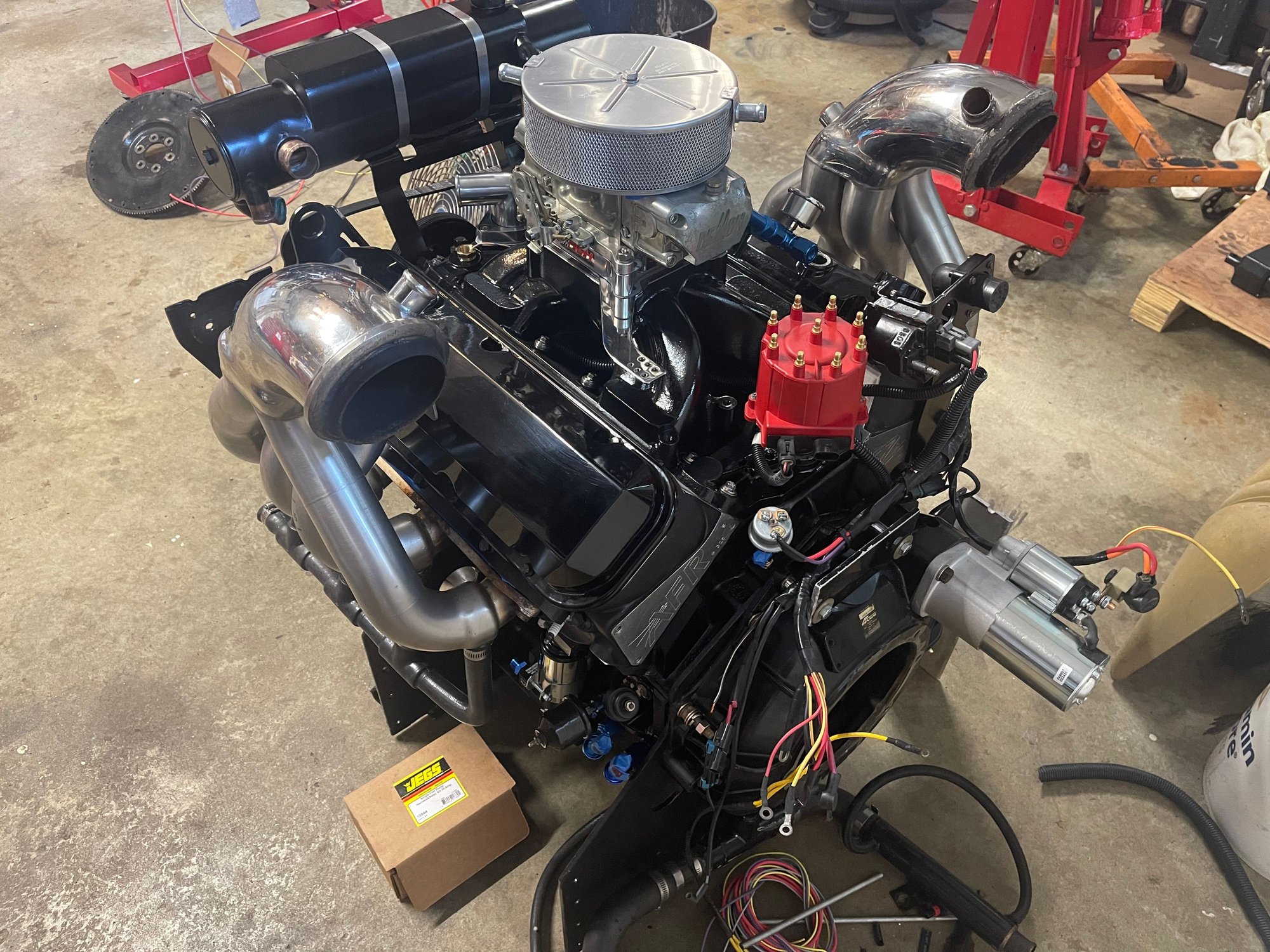

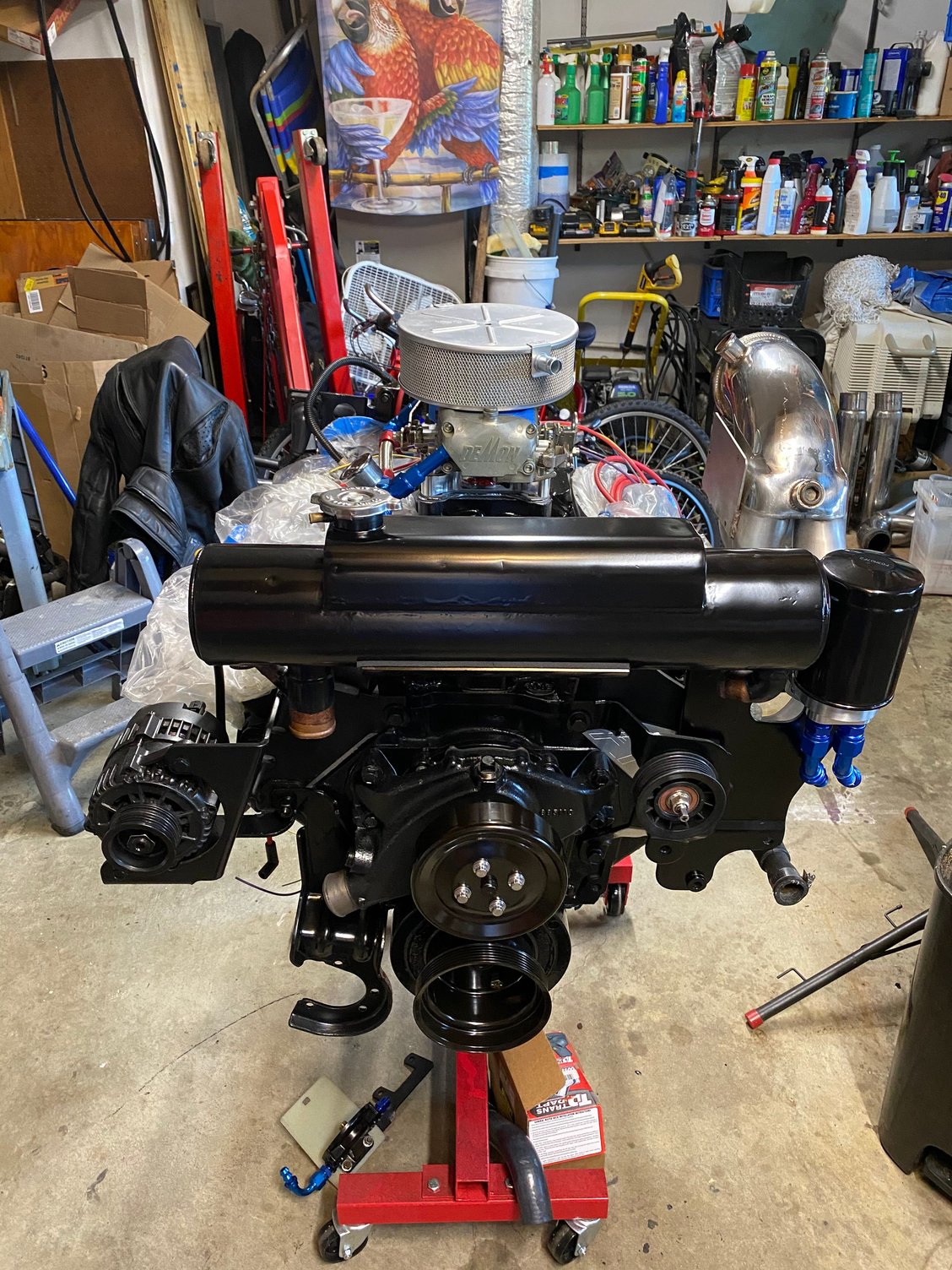

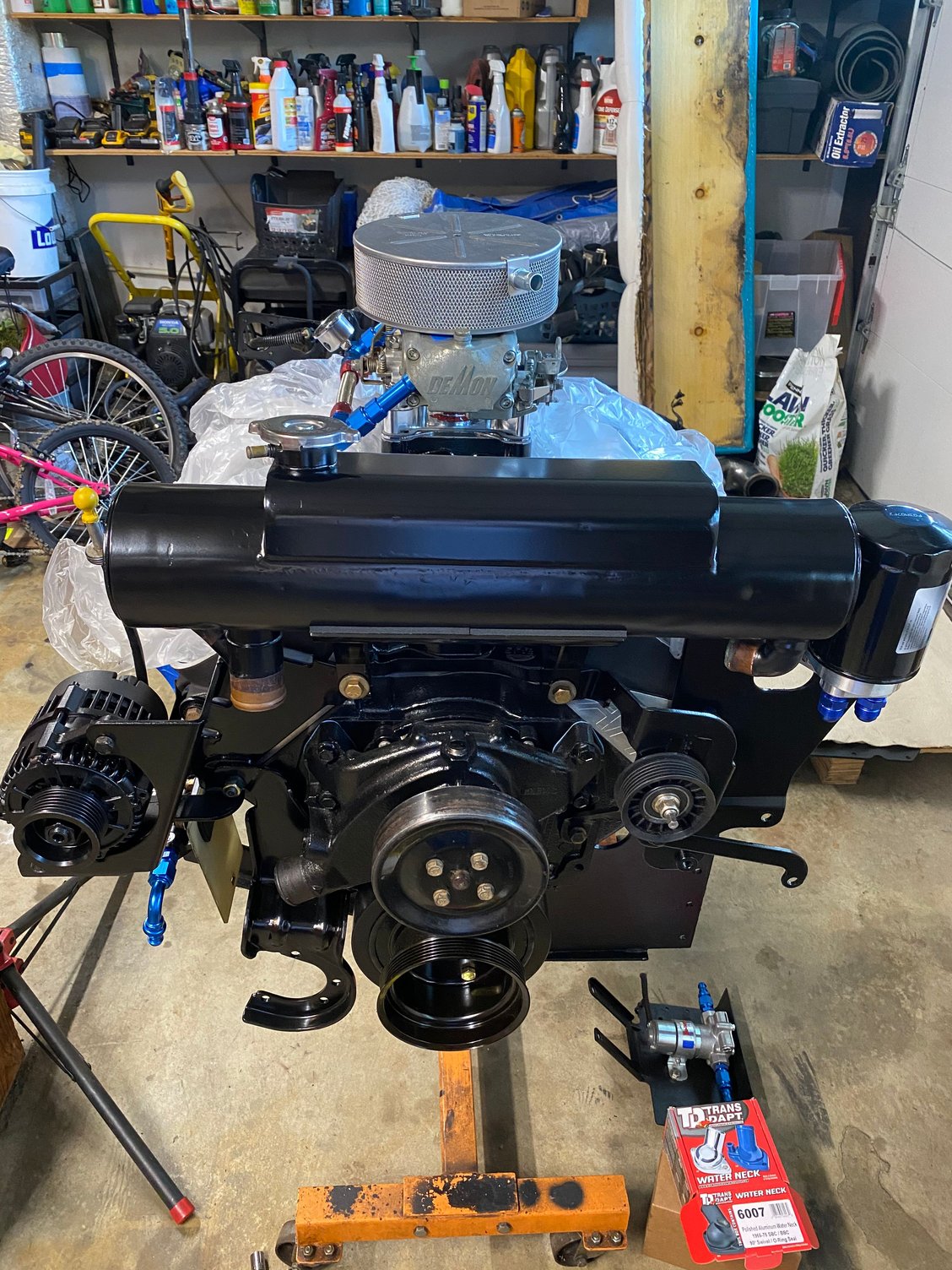

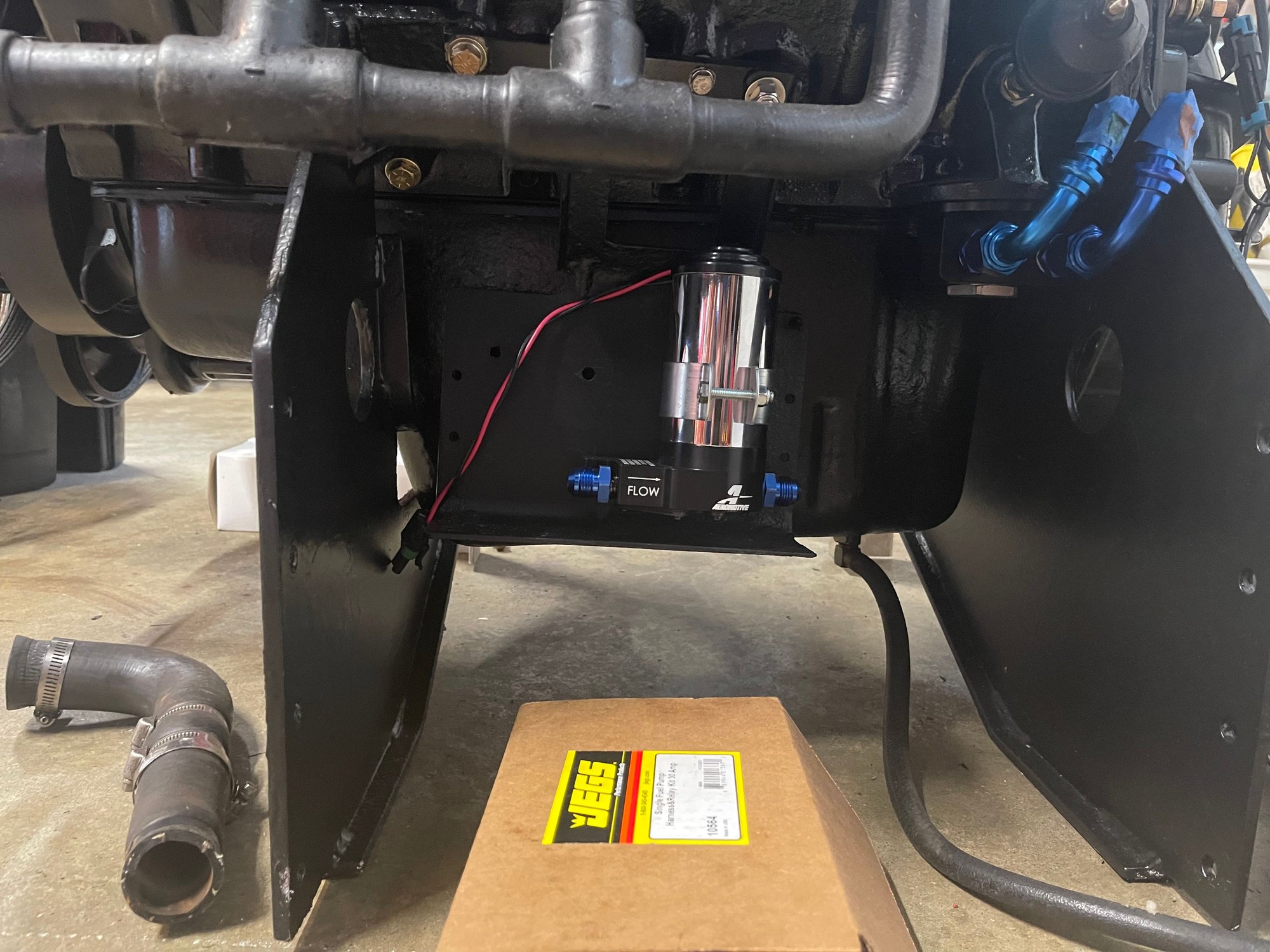

The 509s. What a pain rerigging everything is. I’ve got the wiring mostly figured out and now I’m onto plumbing. I found that the placement of my oil filter heads wouldn’t work so I’m making brackets to relocate them to the port cylinder head. That cleans up some of the hose routing and keeps stuff away from the exhaust. I’m also making new brackets for my oil coolers. Cutting aluminum plate is a pain. The cutting wheels get jammed up with aluminum slag. Just saying.
One area of real concern was the fuel pumps. I wasn’t comfortable using my Holley blue pumps (not USCG rated) so I bit the bullet and ordered a pair of Aeromotive 140 gph marine-rated fuel pumps. I figured $600 added was a much better direction vs blowing up the boat (and friends and family). They’re mounted and now I just need to plumb them in.
Work is stupid busy right now and I’m spending a lot of free time doing just that - work. And some short but fun traveling (my gf surprised me with a weekend in Ocean City MD to celebrate my bday). This week once some work fires settle down, I’ll be able to finish things up.
I need to get my tails welded for O2 bungs. That’s something that needs farming out. That’s about it to wrap up. Haven’t decided on dyno yet. I’m not even sure if there’s room or time to get it done with our friend out here. Will check though.
TomZ 06-29-2021 11:54 AM
Some pics…
https://cimg3.ibsrv.net/gimg/www.off...d8276e7b8.jpeg
This the mock-up work-in/progress for the coolers and filter heads.
https://cimg4.ibsrv.net/gimg/www.off...884a903ca.jpeg
Starboard engine.
https://cimg5.ibsrv.net/gimg/www.off...fd1791f3e.jpeg
New Aeromotive 140 GPH pump.
https://cimg8.ibsrv.net/gimg/www.off...4d195c243.jpeg
Port engine.
https://cimg9.ibsrv.net/gimg/www.off...2cc10d898.jpeg
Spaghetti.
