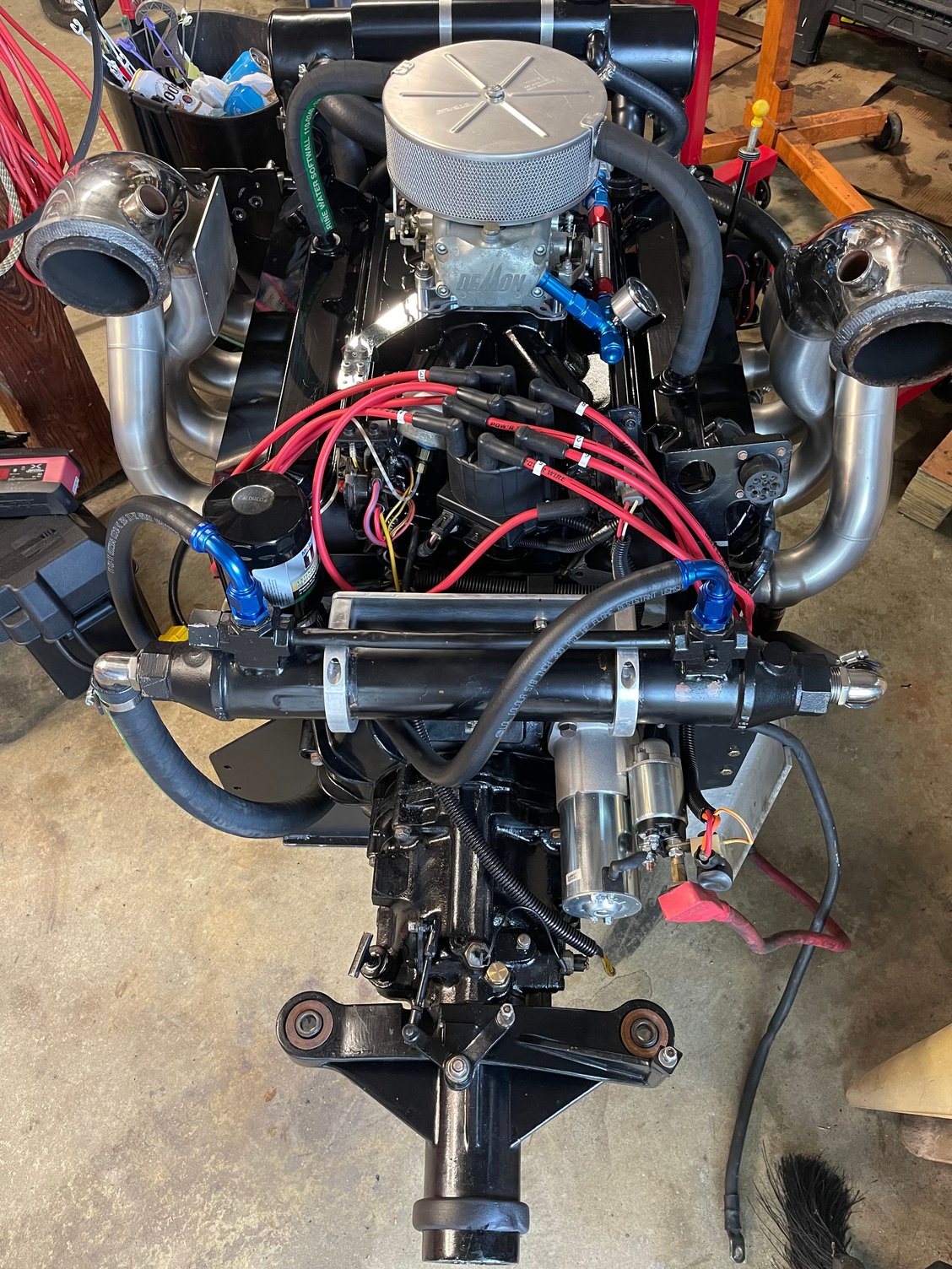

TomZ 07-17-2021 07:11 PM
One down and one to go…
https://cimg3.ibsrv.net/gimg/www.off...7c05d1c21.jpeg
TomZ 07-17-2021 07:17 PM
Everything has been cleaned and painted. I wanted it to go back together with no shortcuts taken. I still need to clean up the trans coolers and make new lines etc, but at least the transmission is assembled.
Fair estimation, two weeks out for installation. I just ordered more hose to replace everything in the bilge. Might as well do it now… the engines have to come out to replace even small pieces.
I’ve also redone the connections to the water pumps. The MPI pump positions don’t match the offshore mounts so I’ve gotten creative with elbows and bends to make them work better. The idea is to keep hoses from breaking and making life easier when it comes to changing impellers.
I’ll get some pics to share.
