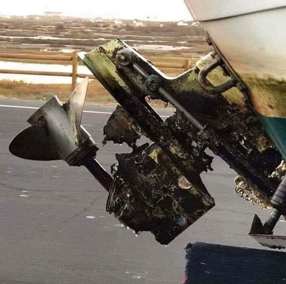

Satire:
Look out for this......
”Still runs.....”

How The Fuhhhh?

Originally Posted by SabrToothSqrl
How The Fuhhhh?
Electrolysis. There was some poor dude with brand new outboards in a marina where someone upstream dropped a cord in the water or sumpthin sumpthin like that, but they looked similar at less than a month old.
