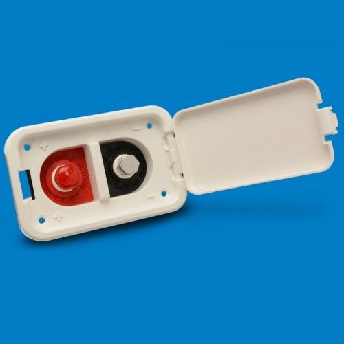

These are cool. From Eddie Marine and surely other places.
Exactly what I'm looking for! Thanks.

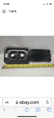

Found this for 1/2 the $$$.
https://www.ebay.com/itm/284074485171
