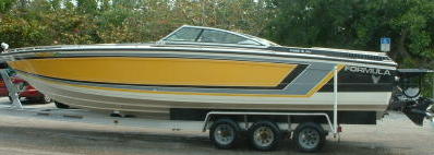

Ive gotta 87 311 with 420's. I run a 25 pitch , three blade, 4300 RPMS . Freshwater, 69 MPH GPS.

Eliminator, I bought a 302 yesterday with the same paint scheme.

Hey Eliminator,
I have a 311 also, 1989. Your yellow 311 is just plain gorgeous!! Always likes the yellow paint scheme. Now that I'm done drooling over your "beautiful bird", I'm thinking your RPMs sound a little low. I have 454MAGS, I see you have 420s. Basically the same motors. Mine are supposed to run at about 5000 to 5200. I'm running 23s. Your speed sounds real good though. Have you had that low RPM checked? Is it right? No big deal, just wondering.
Once again, nice friggin' boat man!!!!!!

Cuda, nice boat ,love the graphics.....

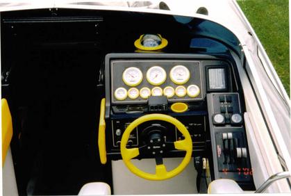

Thirdbird, the RPMS are low for sure.The boat has always ran the same RPM .I have never done any prop swaps . I should probaly drop down to a 23 pitch, just to see if the RPMS pick up. I have a new dash in the boat, all new gaffrig , still the same RPM.

Eliminator,
Even yellow goodies on the helm!!!!!! I gotta quit looking at your boat, makes mine look so normal!!!! You should hang on to that baby, truely unique, not many yellow ones around.
