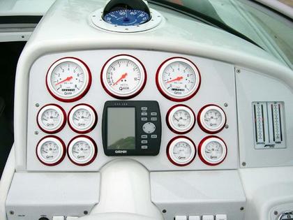

Thanks for the info. How do you like the 182c. I have been looking to upgrade from the 128. It does not have mapping capability. How/where did you mount the 182c. I would like to mount it in the same location as the 128. I believe the mounting hole is the same, but the outside footprint is larger. It will be a very tight fit with the stock formula gages. Has anyone tried this combination?
tesheer is offline
Old 09-24-2003 | 01:59 PM
tesheer's Avatar
Joined: May 2003
Posts: 127
From: Lone Star State
Pic of GPS
tesheer is offline

Tesheer, How is this for service? 182c just fits. There was nothing there before. The boat is a 382.

Ask and yea shall receive. Thanks for the information and pic. That answers my question.
