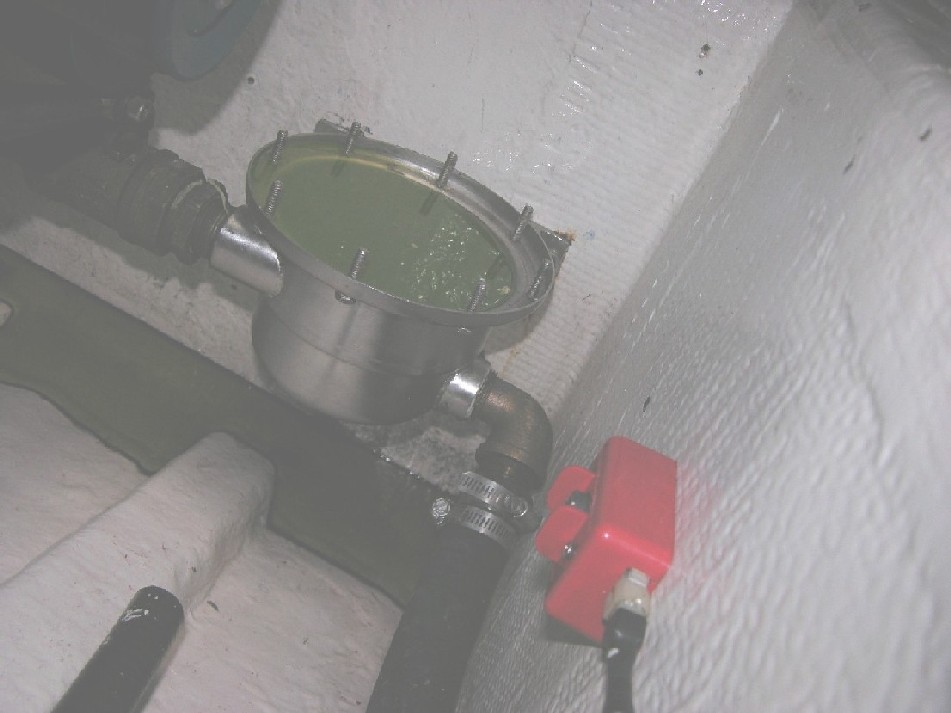

Alj- this was from Canada....worked on it for a while. Some stuff was good and some bad! Many is the time i would like to have the extra 5 feet you have in the rough stuff. We actually wanted a 40 but timing was not right i guess. Thanks much for the strainer info. Here is a pic with what we have.... and thanks again for the info.

Dave,
That sea strainer looks like the GIL marine unit but without the barrel clamp outer ring assembly. Definately not the Perko unit like mine. Yours uses a plexiglas cover and the cover bolts down. Check with Teague Custom Marine in Valencia Cal. They have one that looks similar. GIL marine lists a wing nut style plexiglas lid as part #0913270. Not sure if GIL is still around but their phone used to be 216-354-6800 or 800-624-9805.
But Dave....don't worry about it. I'll take care of it after you drop it off at my house

Our strainers were old Gil's...unfortunately they don't make these lids anymore so i will have to get them remanufactured here locally or buy new units. Bit by bit the whole boat ends up being replaced it seems.
