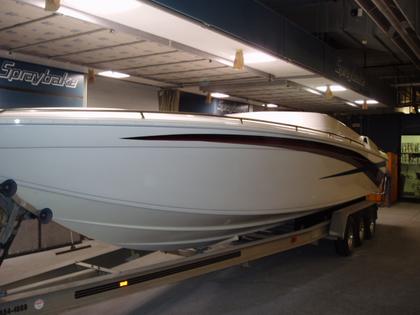

Start with the graphics. We painted the boat with all metallic pearls. it is hard to see in the pictures.
