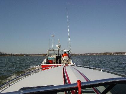

The survey was done today and then we did a sea trial. I was very impressed with the ride, slices right through a 1 1/2 chop.
But as we were coming back in at WOT, something went "snap" and the motor revved up. Owner pulled back the throttle. Motor runs fine but when put into gear boat doesn't go. A passing boater towed us to a marina nearby. Then we called Tow BoatUS and got towed back to his marina. I wonder what happened. Stern drive was recently rebuilt (I saw the receipt) and this is the first time that the boat has been taken out since the work was done. The search continues...

Drive coupler most likely. Did you smell any burning rubber?

I didn't notice any particular smell. Whatever broke sounded expensive.
And I'm glad I wasn't driving.

Probably the splines in the coupler. They make that noise and no burnt rubber smell. Been there , done that. The shaft is steel and the splines in the coupler are aluminum. Must have good alignment and be kept greased.
