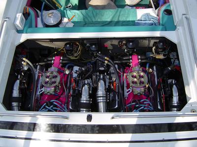

One thing to keep in mind , when I replaced mine on my 272 with Imco Powerflows the elbows were longer and were closer to the stern. When I replaced the rubber exhaust hose , the hoses on the outside pipes were at quite an angle.(the center pipes were straight)
After 5 minutes of hitting the throttles I burned a hole in the sides of the pipes because the exhaust was blowing rught against it
I wound up using stainless all the way to the stern , with just rubber couplers were it met the elbows and stern
See pipe on the right side of picture

"MO" do you mean that the angle of the outside pipies ran in towards the center of the boat rather than "up or down"? From what I can tell in the photo, the "inside" pipe runs straight back and the outside pipe looks like it's running back towards the "center" of the boat. Why did it do that? Did the stock exhaust do the same thing. Doesn't make sense to me that one side would run straight back, but the other side wouldn't if the original system ran straight back. Did that make sense? My stock units both run straight as an arrow back to the stern, and of course I won't know about the angle (up or down) is the same until their mounted, but eyeballing and measuring with a tape measure it appears to be extremely close. I was worried that if the angle downward changed significantly it might cause the exhaust to burn through the rubber. I held one of the new risers against the old stock riser and the angle seems to match.
My biggest worry is breaking off bolts. Anybody got feedback on what is the best "penetrating" oil to use. Come to think of it I probably should just ask Troutly, I'm sure he has a PHD in "penetrating oils".
Did you change yours over with the motors in the boat, or did you pull the motors? I'm sure you must have less room than I do. Thanks for the input.

My new elbows from Imco were longer and came back further than the stock Merc ones. Center two pipes were dead one straight. From the factory , bone stock silent thunder , the outside two angled in a very little. but whith the laonger elbows , it put it close to the stern and the angle greater. Here's another shot
Attached Thumbnails manifold/riser replacement - how hard??-540s.jpg

Yeah, I see what you mean. That shot really shows it. Some mean lookin' carbs atop those babies.
