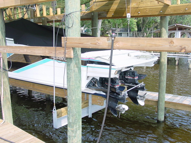

I found these a cpl of months ago and the guy said he would take 600.00 for the pair ....Checking to see if he still has em ...Also with the indicators on the drives not working right I cant really tell where the drives are ..Course I know feel and speed will dictate where they need to be but the main thing is they are not parallel ..drives me nuts ....on the list to get that right ...

That's one nice set-up you have there Mike!! Don't our boats just look cool as hell from the front?!?!?
Oh, by the way, get those indicators fixed. Your drives are all crooked
You can't leave your boat sitting there like that with the drives all cockeyed, looks like a twin screw Bayliner or something. Now get out there and straighten 'em up, that's a Formula order!!!!!!!!!!!!!!!

I would kill to have a boathouse like that. Down here, unless you had a roof on your dock before in 89' you can't put one on. The green weenies complained they were killing the sea grass. Of course trees overhanging the canals provide thousands of more times the shade a roof on a dock would, but it is what it is.
They did "aerial" photography and if your dock shows a roof, you can keep it. Mine as a roof from the "Gazebo" on the dock, and I'm going to reconfigure to be over the boat. However that project is at least three years down the road. Have to get the house finished first, so for the moment, Outlaw is on a trailer, in the drive, with three covers over her, with a fan set up to circulate air for a couple of hours couple of times a week.
That is one friggin nice setup.
Third: you're right, out boats look wicked cool from the front.
Mike, what's wrong with the drive indicators. This is kinda corny, just make sure the springloaded ends of the cables are properly set up against the "circular housing" or whatever that is around the bolts that bolt the tie bar up to the drives. If they are off just a hair, they will slip off the first time the drives are raised or lowered. Just a thought. I had that problem with one drive, when I got it back from having that drive rebuilt, naturally, and drove me crazy till I figured it out.
