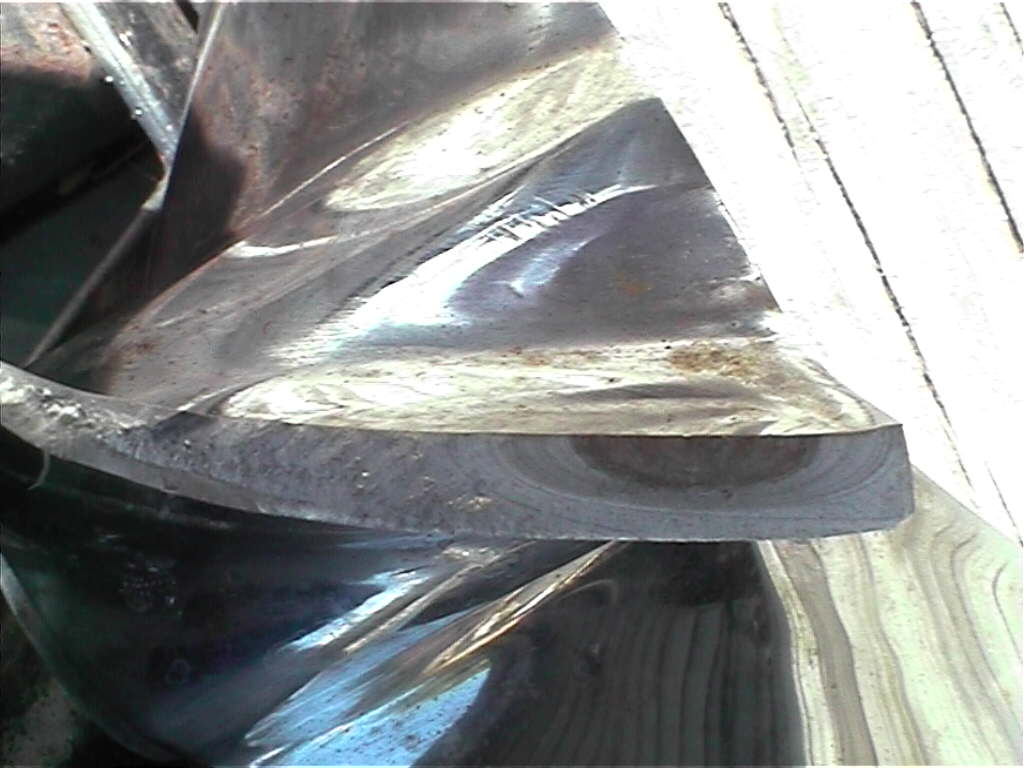

Hey... Perfectmix! get back to me Josh. I finally got the monster out on the water and the bugs mostly worked out. Started to get the rpms up on the new motors after break-in and just in time for the labor day holiday....BAM a whole new problem on the F402. On friday afternoon cranked the beast up and off goes the blade on one of the props. Boy ain't that an interesting vibration on a KAAMA drive. I have the kiekaffer three blade cleavers on this boat. They are 17 x 24 with 4" hubs. Out comes the boat 20 minutes after putting it in! Here's the best part. I borrow a right hand prop from my buddy Ron's F302 KAAMA. You all know what comes next, don't you? On the way up the chain to the sand bar on saturday morning, I open this thing up again. Bam....Ron's prop is now a two blade in need of some serious balancing. Heres the wierd thing. Both props broke at the same place near the hub. Both breaks appear as though the metal is fatigued at the thick point at the rear of the cleaver (trailing edge) and at the inside of the blade almost at the hub. Obviously these three blades won't hold up to the new torque and horsepower but this is ridiculous! Anybody have any history with these props breaking like that? These were the early speedmaster #3 short hub cleavers from what I can gather. Perfectmix, I would like to know how your conversion to 25 spline props went and what pitch and diameter you are running on your F357 KAAMA. The search for props is now on and any help from out there would be greatly appreciated. I have a local guy with small shaft Speedmaster #4 props that might be willing to part with them. They are 6" hubs and they are labbed to 16" diameter and 27 pitch. I'm not sure if the smaller diameter is going to make up for the increase in pitch though. I'm having trouble getting rpm out of the three blade 24 pitch props. I guess that's a mute subject now though! My biggest concern at this point is that I broke blades off two props on my port drive in less than one hour of running time. Based on what these two broken props look like and the fact that everyone that has seen them agrees that the metal looks poorly cast at the break, I'm praying I don't have a drive problem.....aka-a vibration that sets up a harmonic in the prop a certain rpm. Even with the three blade props on there the drives seem to be very smooth. Until the prop lets loose of course. Any ideas out there?????

Sounds like plain bad luck to break two props in one weekend on the same drive. I would think you would notice a serious vibration before the prop snapped if there was something wrong with your drive. Probably would notice some oil leaking past prop shaft seal if you had a shaft bent.
Before you purchase new wheels have them flux checked for hair cracks.

I'm no expert, but aren't surface piercing props under a lot of stress?
I thought I remembered reading that the props should be inspected regularly for stress cracks. Possibly even X-rayed for internal stress fractures.

Josh - thanks for the info. I'll try to call you tomorrow. I've got a few questions. I am going to attach a couple pics here. One is of the rig on it's way on friday to stress test inferior propellers. Next is our beloved logo's on the 402. And then the scientific results of the testing done on friday and saturday. Note the half moon shaped area in the thick part of the blades. And Brent, My pain I think is just beginning. Seems as though I'll be bending over real soon when I figure out what will be the new wheels to stress test on this pig. Got any K-Y? I hear the warming K-Y feels real nice! Here are the pics guys.........
