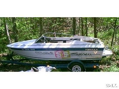

Well I finally paid into member ship and posted a pic. I truly appreciate all the wisdom here. Anyway, this picture was as received, purchased for $1050 with blown upper outdrive gears. I put in new gears, good used manifolds, and have been running it an average of 3 days per week for the last 4 years. Knocked the cheap swim platforms off and refinishing a teak one now. 4.3L V6 factory 4 barrel carb. Runs 51 trimmed up with 1/2 tank of fuel and 2 people with 23p prop. New white gauges and new seats. No insurance (no loan), fits in the garage, and just sips street pump fuel. Built a mild 350 (Vortec Heads, Crane marine cam, E-Brock RPM Air Gap, etc...) which will go in very soon just figuring out conversion couplers and such (switching from 2 piece oil seal to 1, so crank pattern changes). Anyway, let me know if the picture does not show up. Thanks again for the support. Keep the advice rollin in!

Cool looking boat. Good luck with the engine swap.
Just be careful how much HP you put in it. I have an F206 LS with the 350 MAG/Alpha and it'll do just about 60 lightly loaded. I know a guy who also has an F206 but tossed in a 502 BBC with a Bravo. He claims it'll do over 75 but he can't find out how much more. It chine walks terribly. The one time I saw it run I though there was something seriously worng with it. Looked like it would roll just trying to go straight. Very scary. He did say that up to 70 it was stable enough but over that........

Welcome SmallPP,
That ought to be one wild ride with a healthy 350 in it!!
Good luck with the swap.
