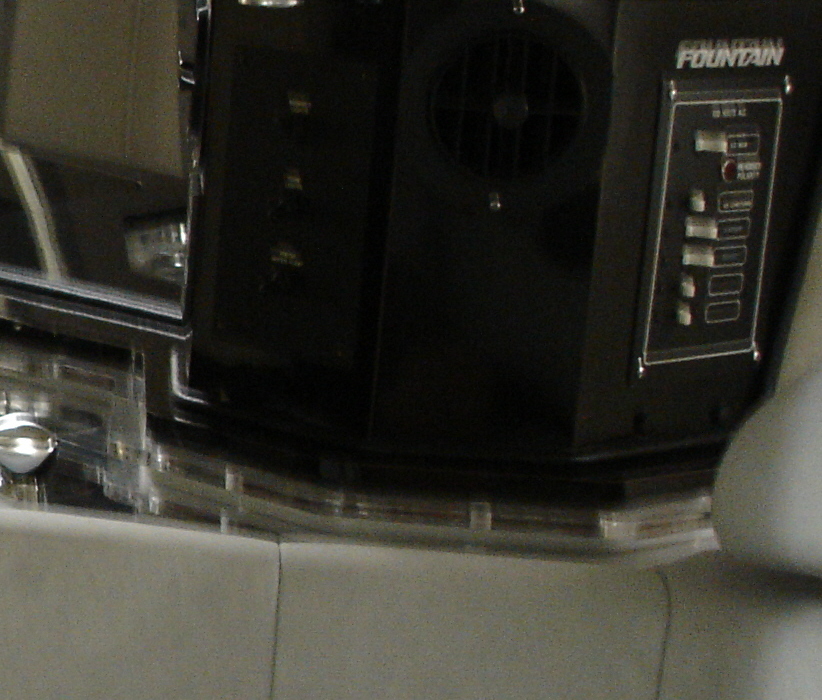

US1, Thanks for the heads up on the Paneltronics panel.
I liked it so much that I'm ordering it to up grade the stock/factory cheapo unit in there now.
I also like your power point for a phone charger cord.
It's perfect....I have 3 accesories and that panel has 3 place switching.
Here is a pic of what came in the old 42.
Good deal.
I did have to mill the top and bottom of the panel down just a bit (to the white painted line) to get it to fit in the plexy panel. You being a brother machinist, would be no problem if you need to also.
We use the cig outlet all the time. Got tired of having a cord run to the dash outlet. Beats me why Fountain didn't install one in the cabin.... Works out great because all the 12v and 110V wires circuts are right in that U-shaped plexy panel. made for an easy job.
