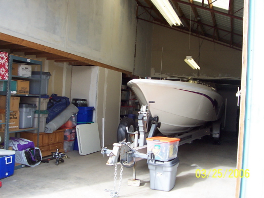

I don't have an anchor hatch but the boat was sitting out side for some months before I bought it.
If the water isn't collecting while the boat is underway, the problem is solved since I store the boat inside.
However, I don't know why there is an access hole under the cabin step or why it is threaded. Is there a plug or some sort of special attachment to blow air thru it?
