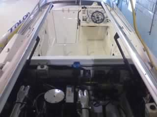

Here is my winter project..............not as much fun as yours.
Take care;
Jay
