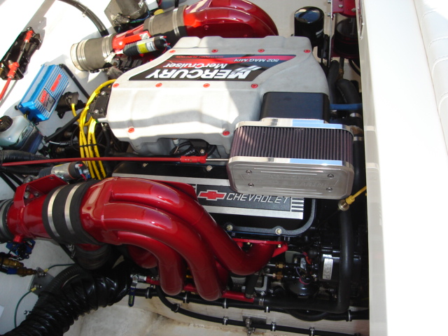

Shoot me a pic if you can. It might just be a leaking bushing seal. Jan (Lightning) is only an hour and a half from us and will presure check older headers (or new). If they're not stainless headers it could be the first sign that they're letting go. Better to check than to loose a mill!

Here is a pic

what number are the leeking from?
