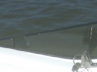

Yesterday I was removing my Bimini top and swung around and hit the side windshield with one of the Bimini's stainless support legs. The base of the leg knocked out a 2 inch square chunk from the top of the port side windshield, just behind the passenger's seat. What are my options?
(1999 Lightning with smoked grey windshield) Is the plexiglass repairable? Would I have to replace the port side of the windshield (if not fixable) or is the WHOLE windshield one big-ass piece?
Looking for a reasonable fix,... slightly classier than an OSO sticker over the damaged area.

Here's a picture of the carnage, just behind the seat:

I need about a 3 x 3 in. square piece to repair.
I wasn't sure if the windshield was a one or two piecer...
good to know it's two. I will consider a thread for a used windshield.. think I would rather try the repair first.
