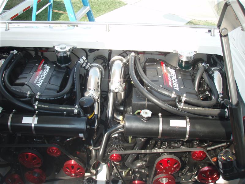

Does anyone know if the failure rate on CMI brand vs Mercury Racing? I was told by CMI that Mercury made them change the flange from the ones you can buy direct. I did something a little different with mine, I run engine coolant through mine except the tail pipe.

racer-x6's Avatar
Joined: Mar 2001
Posts: 1,454
From: Mississippi
It works well, the sea water pump brings sea water to the heat exchanger in the front of the motor and the circ. pump on the front circulates it throughout the system. the only place the salt water gets to is the heat exchanger and the tail pipes. I have been running it for two years with no issues. the temp runs about 175 deg all the time, at my store we have installed this system on 454 carb., 502 Mpi and a 500 EFI.

The 525 efi already has the heat exchanger. So it may just be a plumbing issue. I have the SmartCraft gauges, so I could monitor the heat pretty closely. I'm going to look hard at this set up this winter. Very interesting. Thanks for the feedback.
The heat exchanger on the 496 and 525 may not be big enough and and the way the tank sits on the manifold housing you may not have a port to attach the in an out hose. If I find out any more info I'll let you know.
