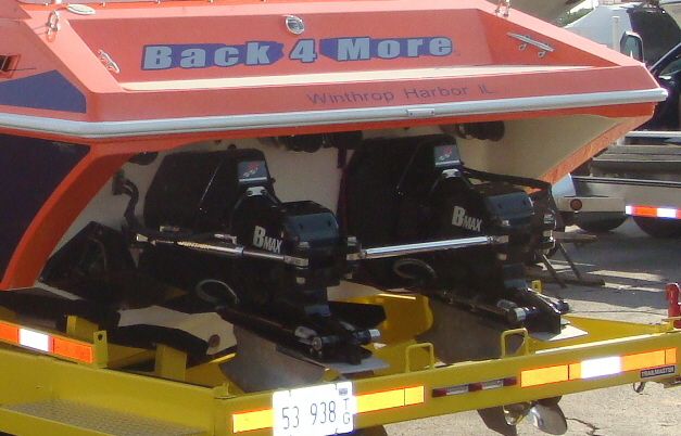

Gets costly real quick with changing your steering and glassing the old holes up.
I would put money better spent toward a good set of labbed props.
