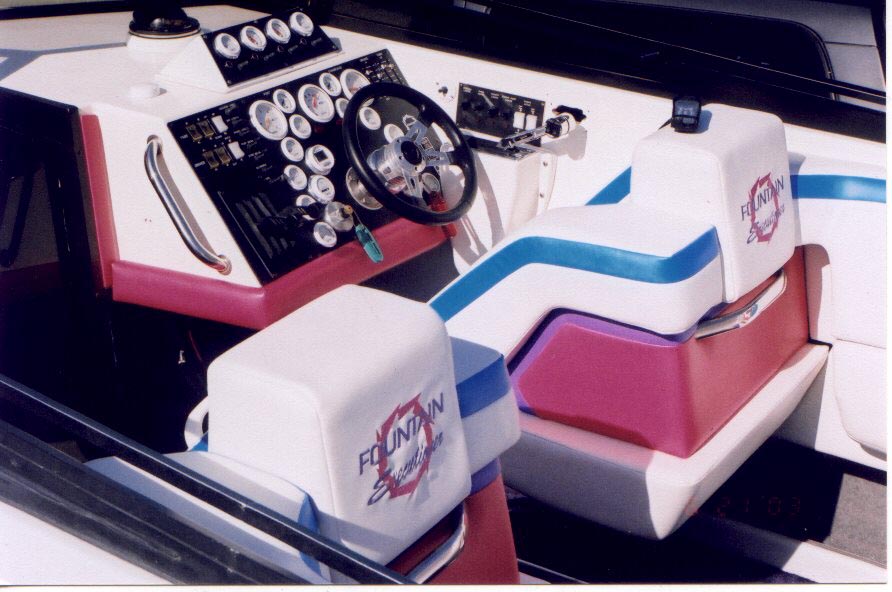

I converted mine over to the right side because with them on the left side, I could never hold a steady rpm while running in choppy waters. With nothing to rest your forearm on while holding the throttles, I found my left arm constantly bouncing up and down while running in choppy seas. Which in turn was pushing the throttles up and down, enough to make the rpm's of the engines go up and down also.
It was very uncomfortable for me to take a long trip and hold the engine rpm's steady. At WOT, it was'nt a problem at all, but I very seldom run at those speeds compared to running at 3500.
Now I'm able to rest the back of my elbow into the front of the bolster, and I even had a small cushion made that velcrows on between the throttle pod and the front on the bolster, that I can rest my forearm on. Waayyyyyyyy more comfortable now. Pics are'nt the greatest, but they're all I have for now. I'll take a few more better ones this weekend.
