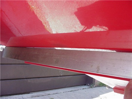

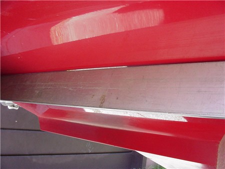

So far no word back from the factory all I could get was some guy named Steve on voice mail. I have a couple of pix so you can get a better idea of what I am dealing with. This is the sterboard side strake.

Sorry that was the area between the strake and chine. This is the starboard strake.

Area between pad and strake

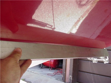

Port strake. The pix don't really give the true scope.
