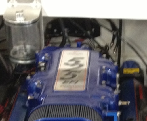

On my 35 the shift cables are mounted to the transom
