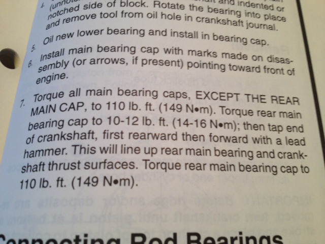

What do I need too torque My main caps and Rod caps to?

This is from the Carb'd HP465/HP500 maunal...They are 502's like your 500EFI's
Attached Thumbnails 500 EFI Torque specs-tq1.jpg   500 EFI Torque specs-tq2.jpg

500 EFI service manual says the same torques and same procedures .... page 3A-52 for the main bearing caps and page 3A-54 for the rod bearing caps.
