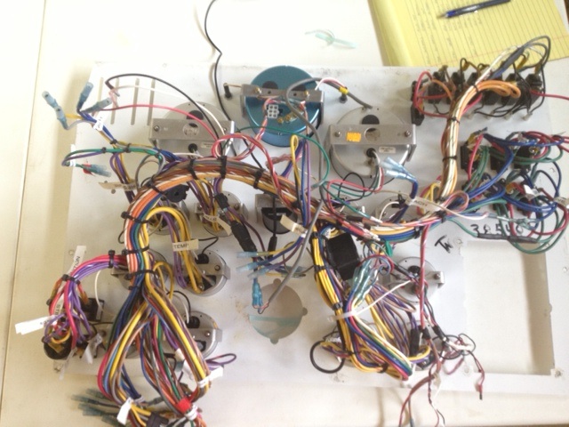

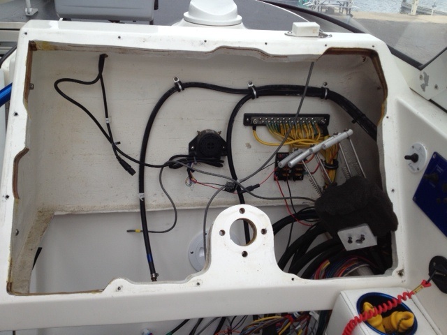

Progress...[ATTACH=CONFIG]508399[/ATTACH][ATTACH=CONFIG]508400[/ATTACH][ATTACH=CONFIG]508401[/ATTACH]

I was able to remove the dash with all of the wires connected, but there are only two harness connectors and everything else is connected with snap plugs, so I divided the bundles of wires into four groups, cable tied them together, and then labeled them individually so I can re-snap them together. There were also a few wires that had to be cut because they were crimped together instead of snap plugs and those will have to be re-soldered once I re-install the dash. The trim/drive switches, ignition switches and panel switches can all be removed from the back and moved to the new panel while still connected.
Overall, it's going pretty smoothly, I started Saturday morning, took me about 3 hours to get the dash out and most of that was spent labeling everything. I spent about 3 more hours on it Saturday afternoon removing the wiring and moving the gauges, and two hours yesterday moving the wiring to the new panel, and now the only thing I have left is reconnecting the LED's for the switches.
It's all pretty tedious work but rewarding watching it all come together. Can't wait until I get it back on the boat. I'd love to come to the Keys for the beer but not sure I'd be so enthusiastic about doing this for someone else... LOL... Here's a few tips on things that could trip you up.
1) Get yourself one of those P-Touch label makers with a few cartridges and label EVERYTHING before you remove a single wire. Take as many pictures as you can and for everything that you disconnect, write it down.
2) The FireBoy LED plaque is glued on the dash panel and behind it is where the screws are that hold the trim/drive indicators. I used a small 1" spackle knife and hammer to GENTLY break the seal of the glue to get it off without cracking it.
3) I needed a two-jaw puller for the steering wheel. My standard 3-point puller with bolts would not work.
4) I took the throttle/shifter assembly apart from the side screws rather than disconnect the cables. Make sure you make note of which way the neutral sensor wires are connected because they were different from port to starboard.
I'd be happy to offer pointers if you need it once you get started, so feel free to PM me.
