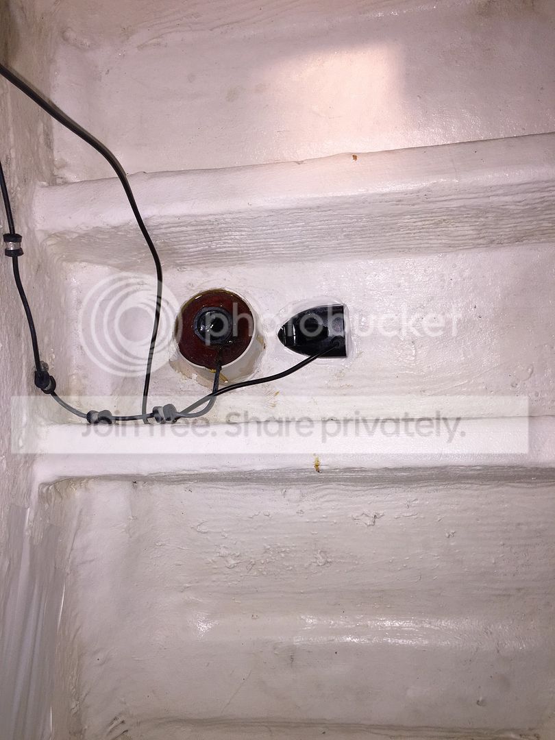

This must be the reason my new depth gauge does not register (95 Fever). I glued it right next to the old one but no bueno. Has anyone had any luck "chiseling" out the old ones in this situation leaving the existing little tube they filled in intact and replacing them?

Padraig I misinterpreted what he meant by cored. I was thinking of the hull construction, wood and fiberglass vs composite. Mine is through the hull right behind my step in the hull. Where my transducer sits, they left a small spot where they didn't glass over it.
