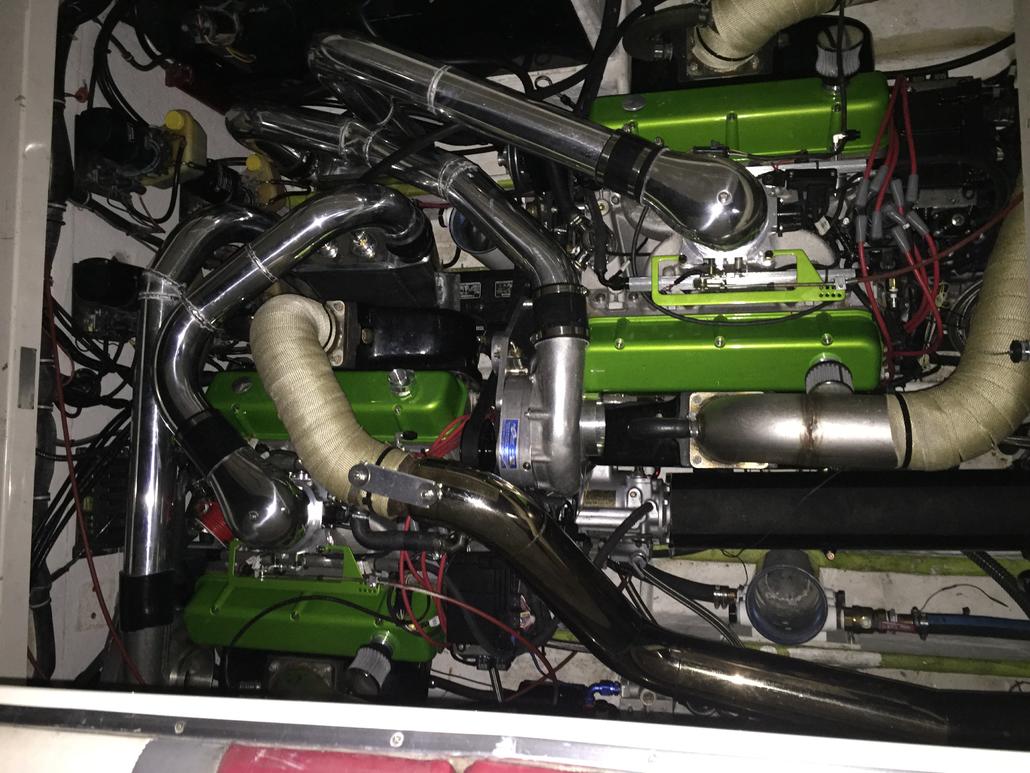

[ATTACH=CONFIG]559342[/ATTACH]
Here it is with the rest of the intercooler pipes on.
Why the exhaust wrap? I always wondered when a intercooler is piped like that doesn't all the right angles restrict flow?

  #37
Joined: Jul 2012
Posts: 1,248
From: indianapolis
The exhaust wrap is because I had to put the exhaust close to the Pcm and distributor. As far as the bends they are 3.5" mandrel bends. They won't restrict the flow.

Old 09-13-2016 | 07:54 AM
  #38
Joined: Jul 2012
Posts: 1,248
From: indianapolis
And the exhaust had to route to the outside of the transom assemblies because of how close I'm running the drives. I had to cut the inner plates as it was so there was no room for anything to go between the drives.

Old 09-13-2016 | 02:52 PM
  #40
Joined: Jul 2012
Posts: 1,248
From: indianapolis
It's 4-5 inches away and will be fine I'm sure but the one time I eat an impeller or clog a strainer I don't want to have to replace a harness. I think it makes it look all business. The mandrel Bends you can just buy and then as you can see from the picture I cut them and then weld them to make the pipe. Same principle of how they do exhaust also. I always buy my aluminum mandrel vans from frozen boost.com. That's also where the intercoolers it from, pretty nice stuff at a great price. Power wise Professor Haxby said 925-1000 with the pulleys I have now.
