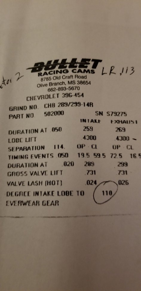

Originally Posted by KWright
This should work.
cam?

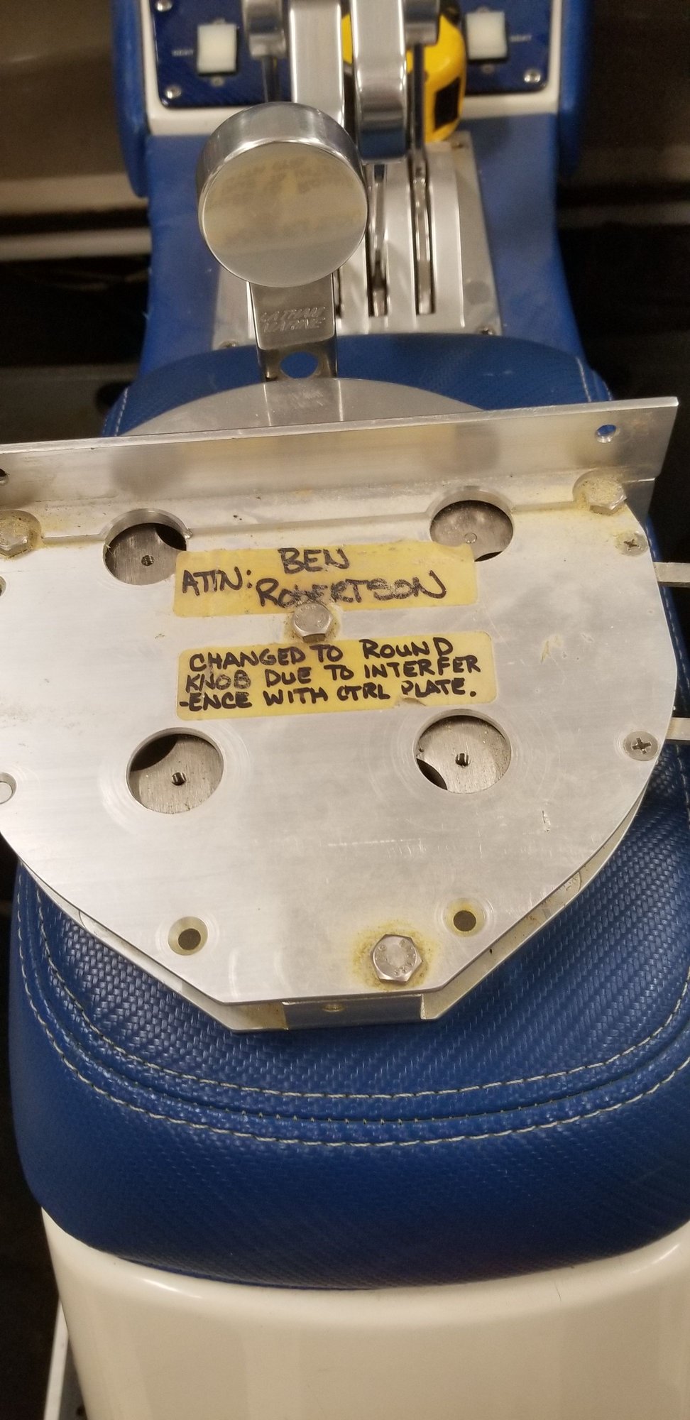

Found this while disassembling the interior.

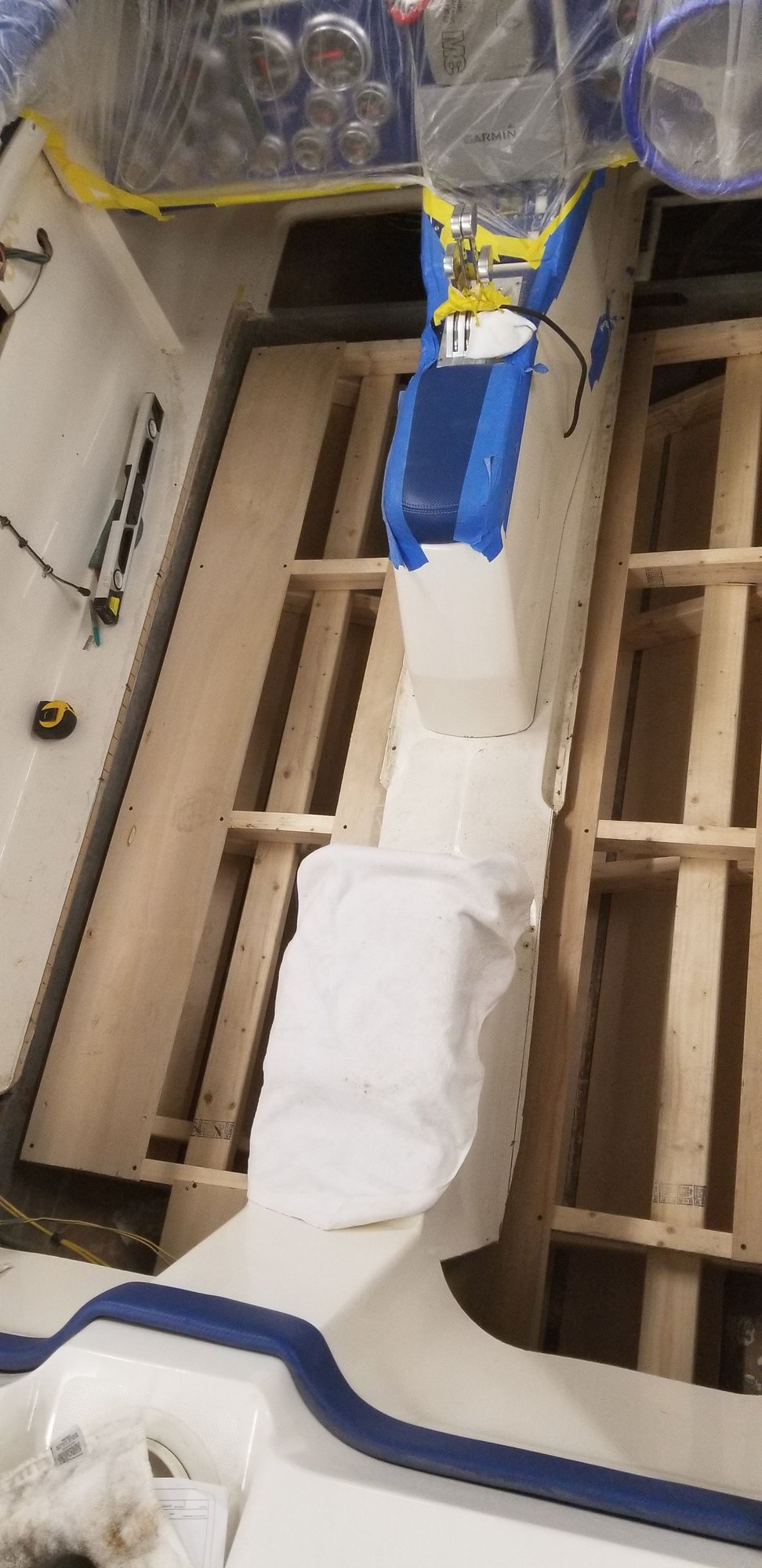

No turning back now!

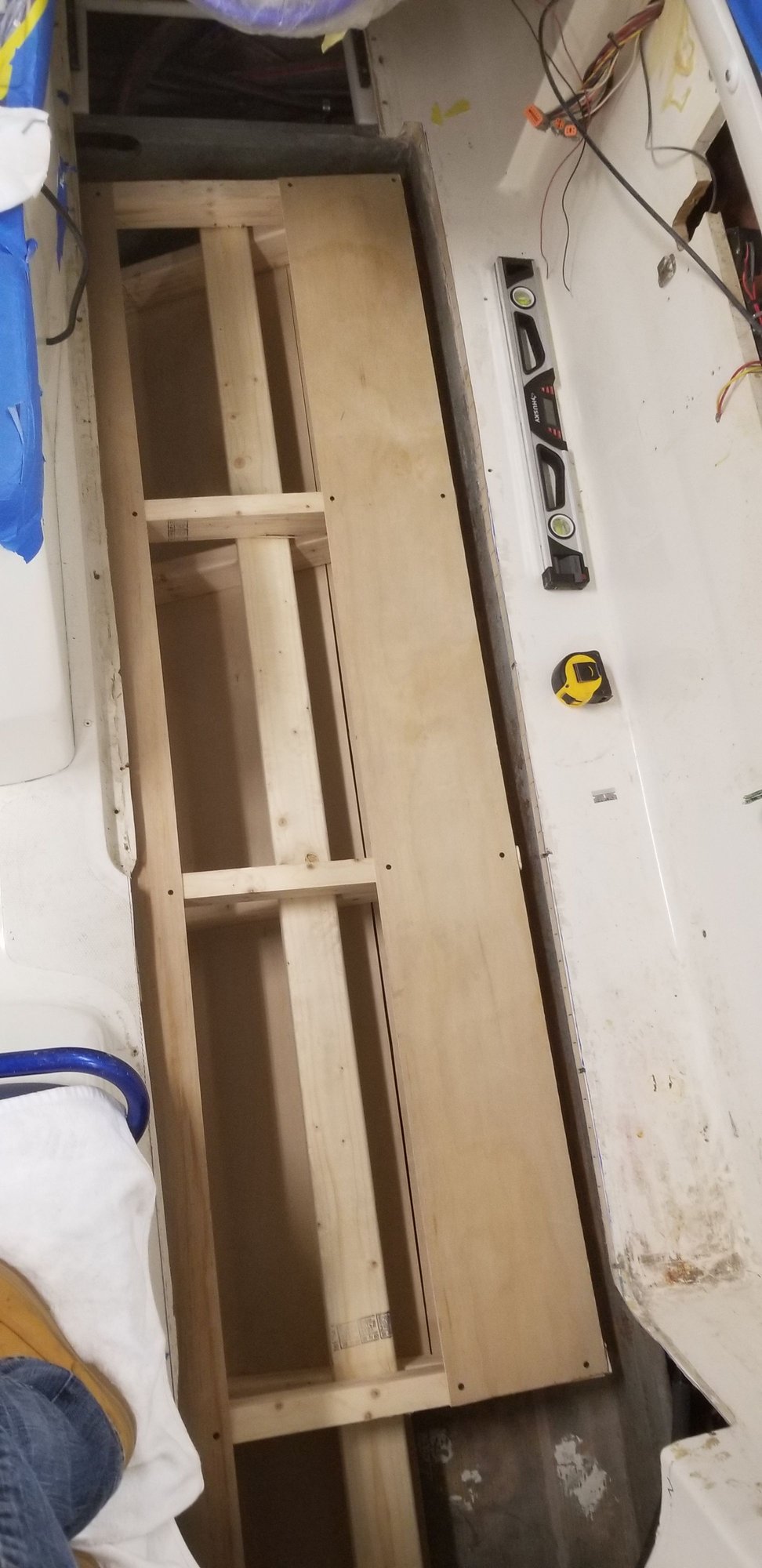

Mock up tank made for starboard side.
