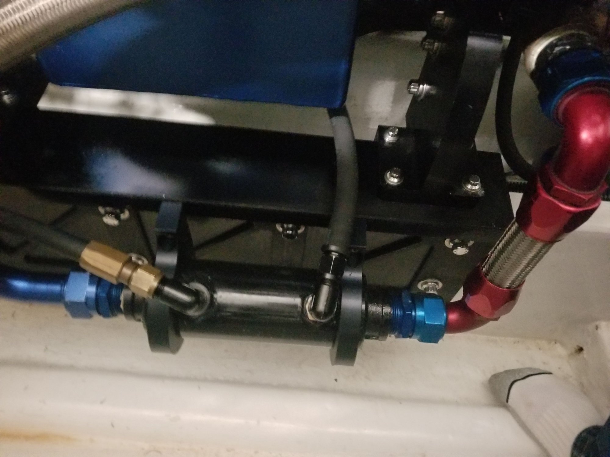

New power steering cooler big enough to handle both pumps
KWright is offline

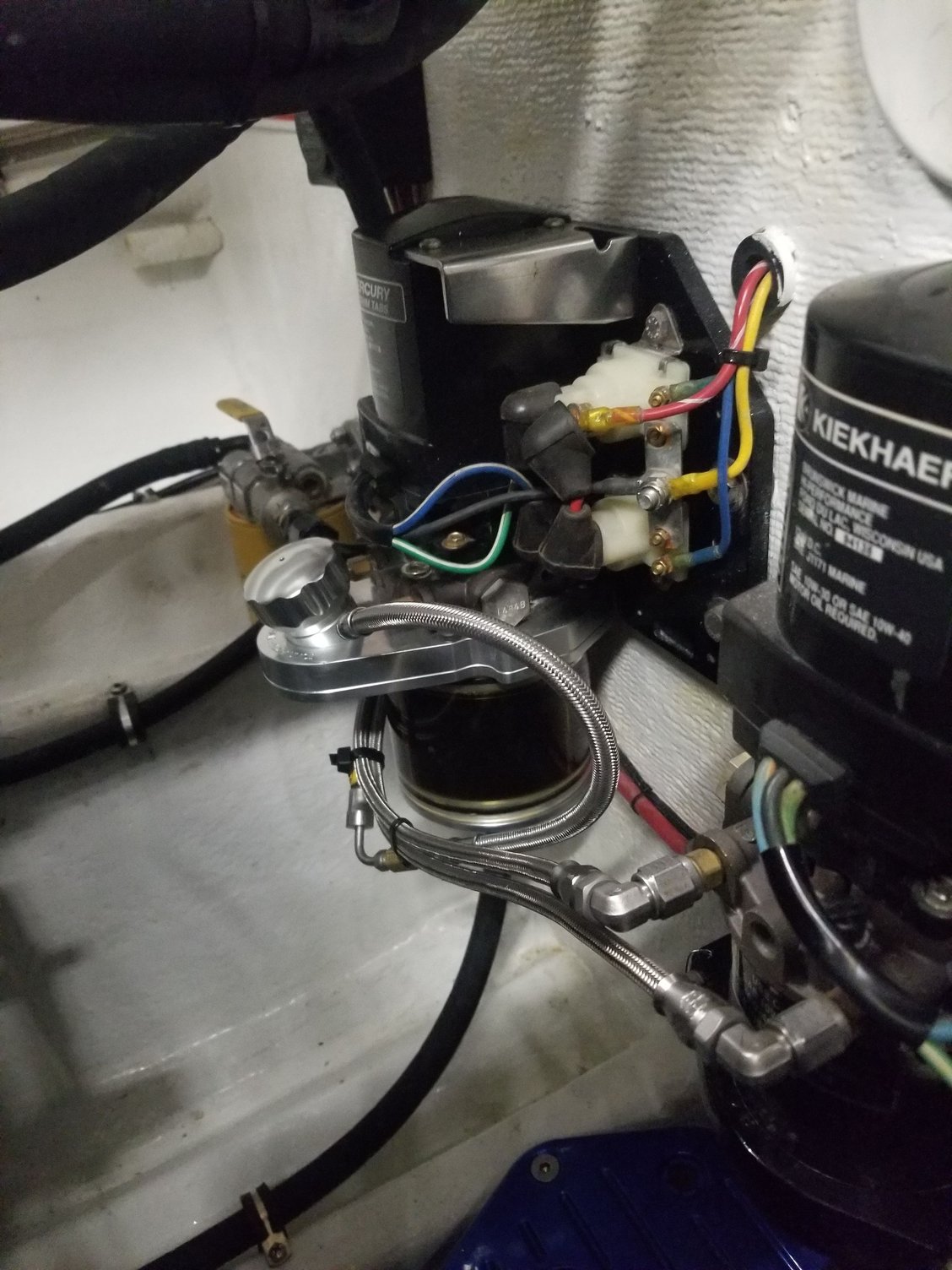

Replaced plastic reservoir tanks with some billet ones.
KWright is offline
Old 12-01-2020 | 04:19 PM
  #455
Joined: Jul 2009
Posts: 8,527
Likes: 706
From: Taunton Ma
those are sweet. Who makes them?
Unlimited jd is offline
Old 12-01-2020 | 05:49 PM
  #456
Joined: Mar 2011
Posts: 943
Likes: 277
From: So. Burl. VT.
Cp performance mayfair tank they are pretty sweet.
KWright is offline

Ive got those billet reservoirs in my boat, they are nice quality

Awe shucks, you all have me spending some more money now (billet reservoir bottles).
I'm really glad you posted that. I've been looking for a solution to upgrade those reservoirs and had no clue those existed. They also offer a "#6" pump assembly that actually looks reasonable. NOS pump assemblies are going for like $1500!!! With that metal reservoir and the fill location that is very tough to service.
