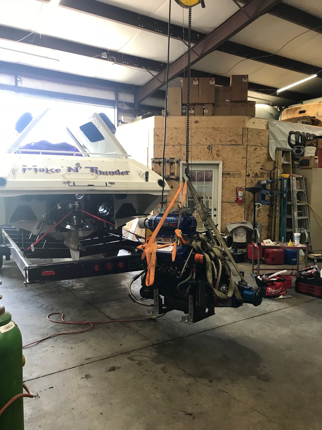

I was on the dyno last week. After several jet changes I was unable to get the afr’s low enough. We called it a day and at home I found a really bad leak at the carb adaptor base plate gasket. Got that fixed and will be back on the dyno monday/Tuesday. With the few 5200-5400 rpm pulls I we made it still made 1000/1000 at 28
deg of timing and alittle over 9lbs. I Think at this setup with timing and revving to 63-6500 they will be at 1200. They made 980ft-lbs at 4K! Got gimbal replacement done, bilge painted, starboard engine in. Mounting fuel pumps and return regulators now.

Old 05-29-2018 | 09:13 PM
  #158
Joined: Jul 2012
Posts: 1,248
From: indianapolis
indysupra is offline
