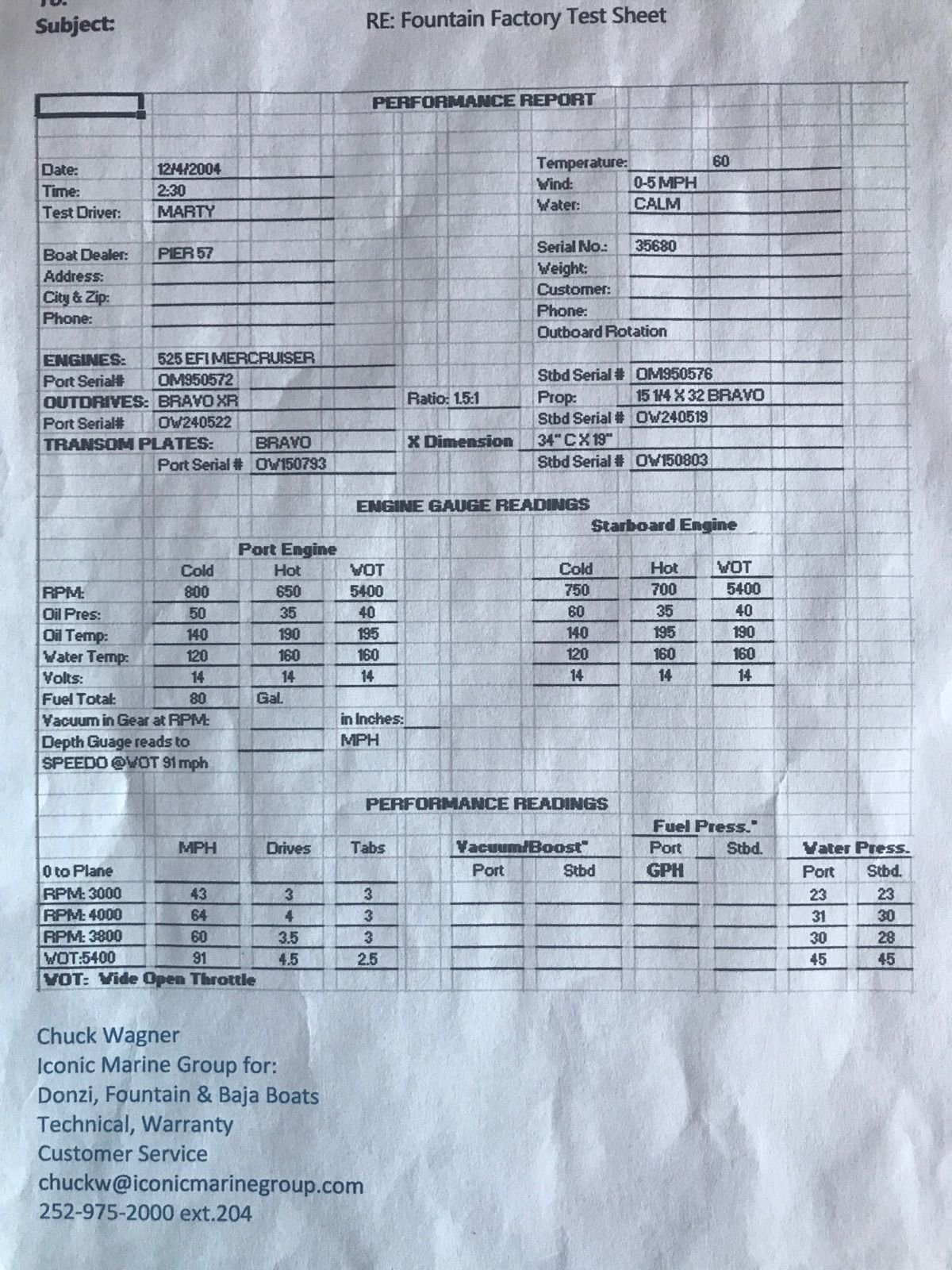

I know this has been discussed a lot but I'm looking for help on props in or out. I'm picking up a 05 35 w/ 525's next week. Owner said the boat is faster and handled better spinning out. Stock bravo 32's best of 93mph and spinning in was 91mph. Fountain test sheet even had them out! Everything I have read on this hull says in is faster and out handles better around the docks. On our water test it was hard for me to tell since it was my first ride. It seemed to take a while to get from low 80's into the upper 80's but we did have 4 adults and 3/4 fuel w/ air & water temps on the 80's. I've heard these boats do take time to get to top speed.
I'm not questioning the owner's knowledge since he has tested both ways. I'm just surprised based on everything I've read....

I don't see any mention of prop rotation - does your report look different??
Here is my 09 42 (700's) report.
Here is my '02 35 (575's) report.

My bad, owner stated boat came from factory spinning out. I'm going to try them spinning in and see what happens. What's the easiest way to reverse the shift cables? At helm or in engine bay and specifically, how is it done?

So you say the factory test shows 93 turning out and 91 turning in?
You might want to have your seller show you the 93 before you drop the cash.

Post your Performance Report. I'm interested in seeing the reference to in/out.

Could be my old eyes, but I don't see any reference to prop direction on your Performance Report. I certainly don't know it all, but my understanding is Fountain set up their boats to spin in (to win!).

Right above stbd engine info it says "outboard rotation"
