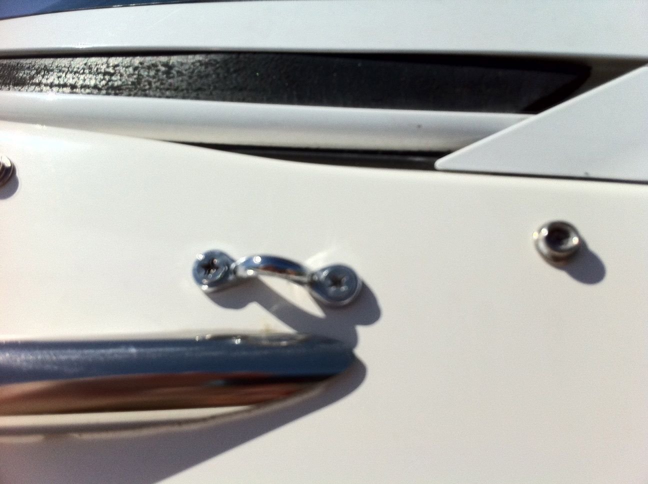

Our old 27 had snaps into fiberglass, cover covered windshield.
