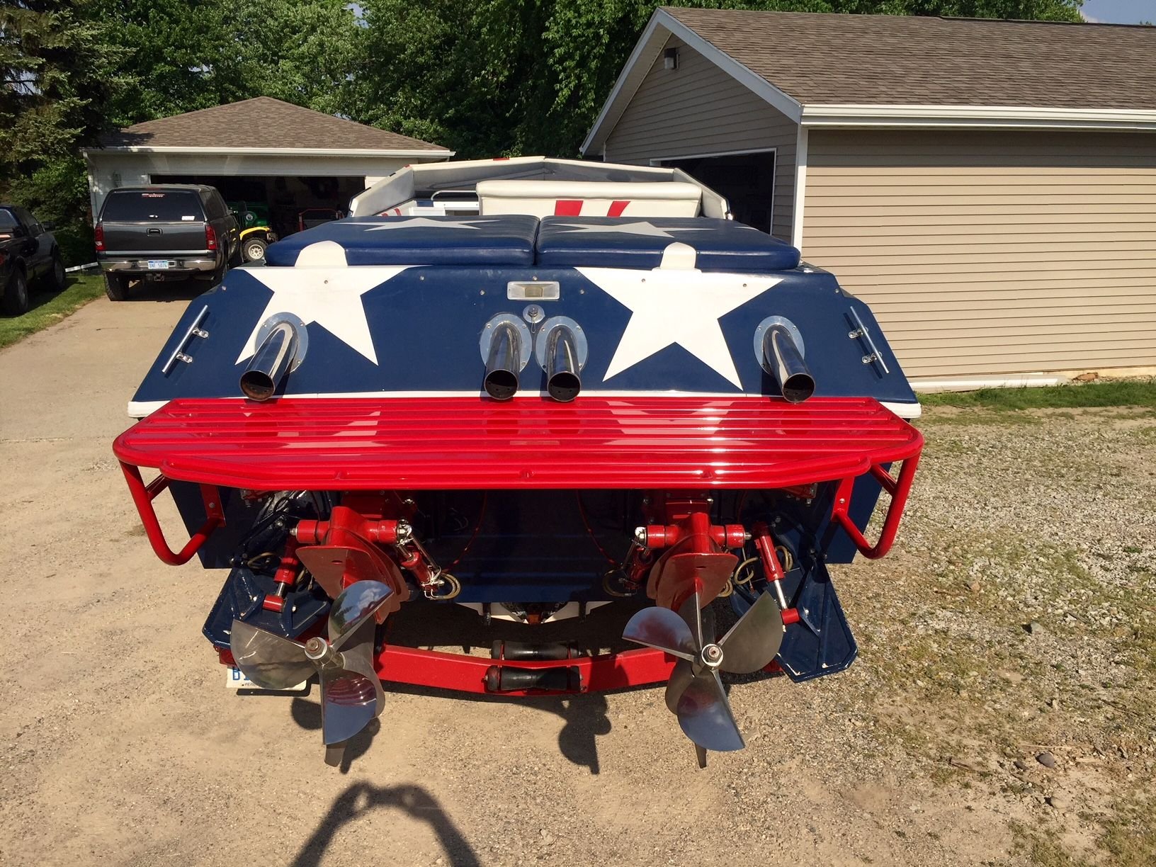

Sorry to ask this question, i know its been asked a million times, but searching the forums its hard to find an answer to this question for my 12 meter straight bottom as most are for stepped hulls. I have #3's and currently spinning out. Everyone says "in to win" but just wanted some advice from people that have ran both ways with this hull as swapping drives is a pain. With the props spinning out i definitely get stern lift and the bow stays down. I assume with more bow lift i will get less drag in flatter water but curious if its worth it or not. Appreciate any advice!

I have an old 12 meter with SSMV on the back. I started with out and the boat handled and backed great. I changed to in and the boat picked up 10 mph. It handled great but backing up is a pain. The drives are mounted high, bullet even with the bottom. I still have them spinning in and put up with the backing up, just have to compensate for the transom splash.

Thanks Charlie, i know i have to see top end gains with spinning in but was on the fence. Will have to swap em and see what she does. Thanks for the info! MIKE

Definitely helps on the staggered boats to tilt the drives up a bit when docking, gets the wash more under the boat, maybe this technique will help when spinning in on your set-up.

My setup is not staggered

That helps with my side by side as well. If you don't they pretty much will do nothing in reverse. Like you say when you tilt up the prop wash goes under the boat and for me doesn't really seem that bad then.

Gotcha, misunderstood the first time reading, sorry. Thanks for the info guys and will let you know how it performs after switching
Agreed, a little up from neutral does make a difference. Side by side here as well, high X and spin them in.

After switching them around I definitely gained some bow lift and probably 3-4 mph too. It was flat water and full on fuel so might be a touch more than that. Was worth the time of switching them for sure
