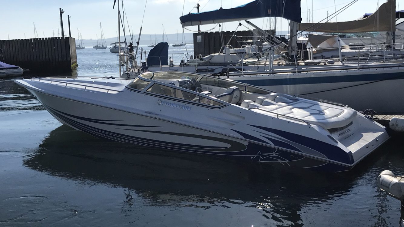

Please post some pictures of your 33

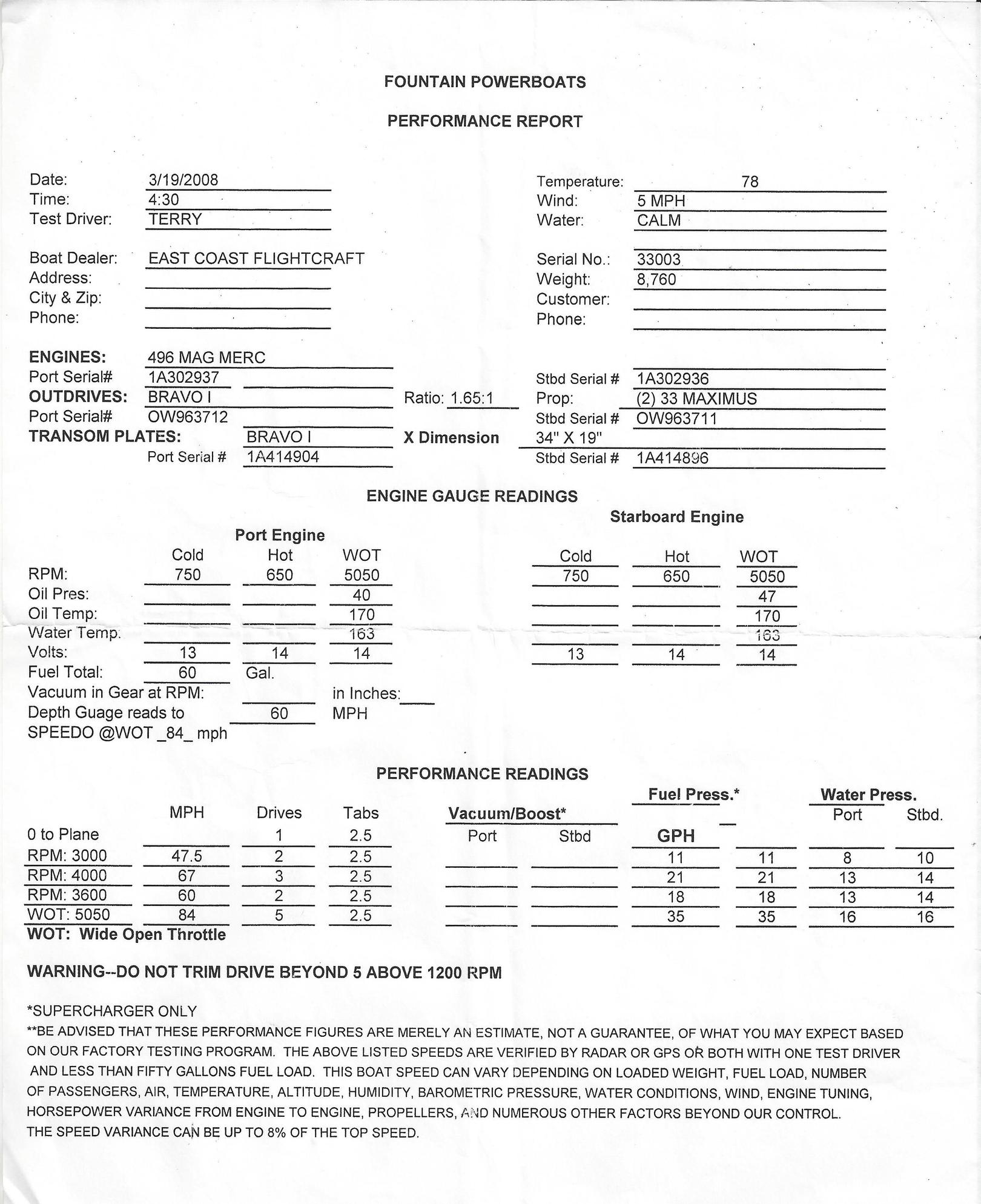

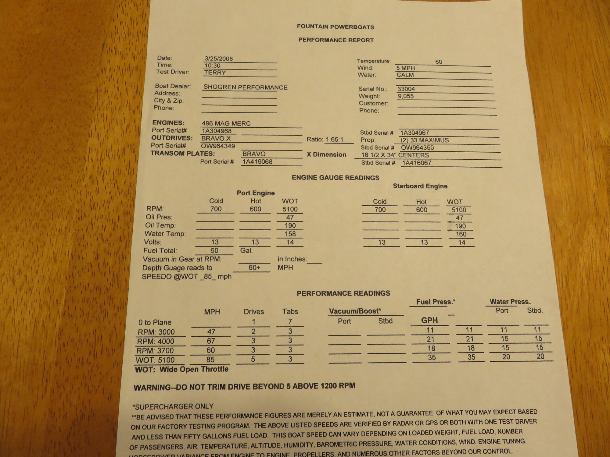

Checkmate ZT 280,,,do you see 85 like the fountain report states?

No just 82 ,That number must be with one person, low fuel ,going with current in river,and a tail wind.
