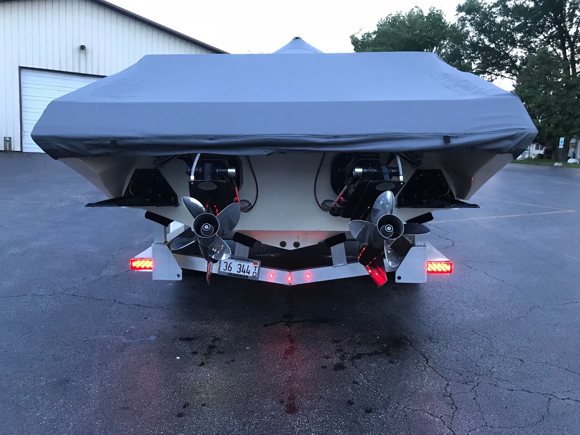

just removed my props, does the prop marker "R" go on the port or starboard engine? Previous owner had it on the Port motor

Does this help?single step spinning in

If R was on the port side then there spinning in, common on Fountains, put them back on the way you found them

A lot of fountains spin in. Put them back the way they were and check it before launching
