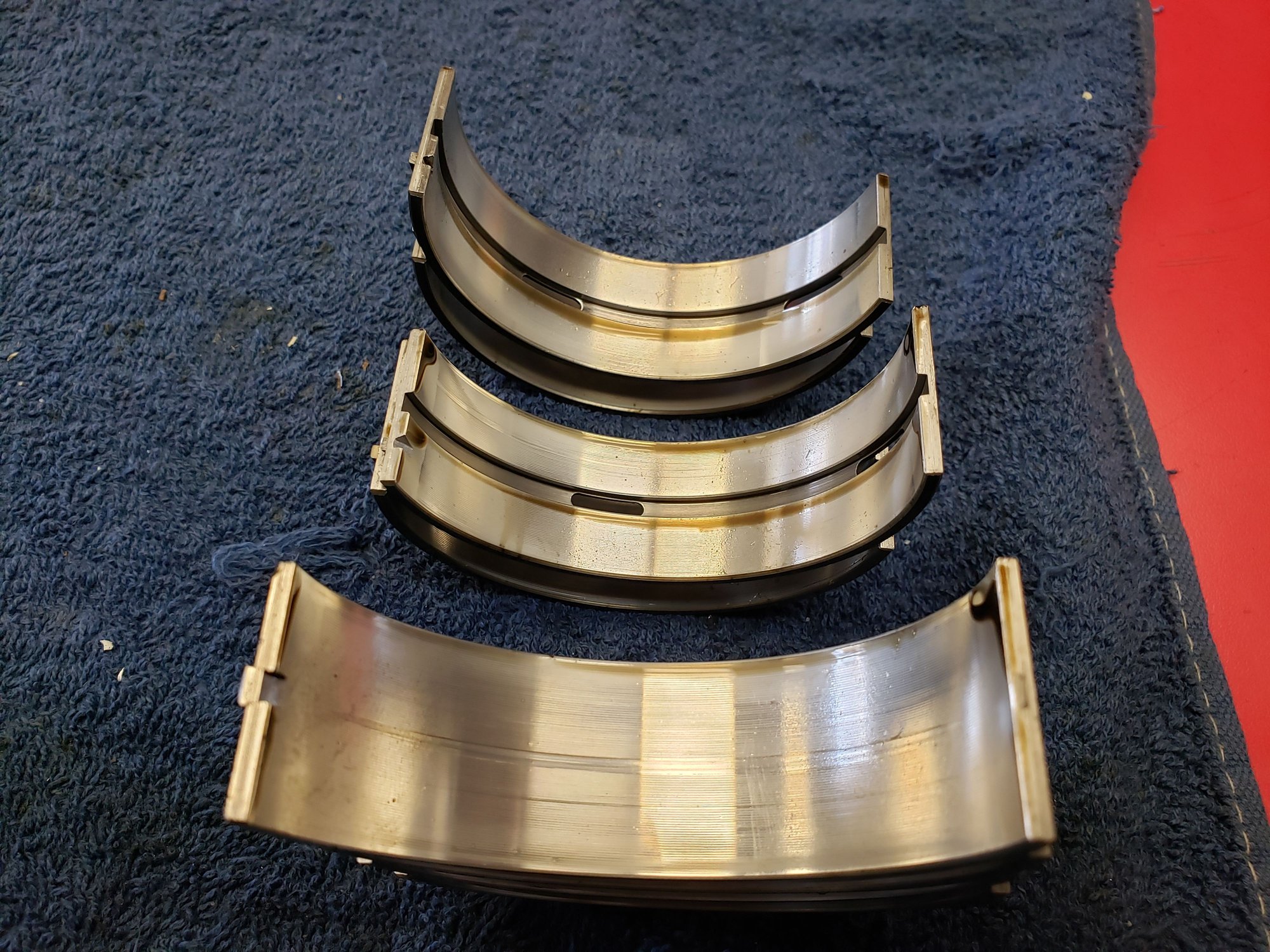

Old 09-20-2021 | 09:36 AM
Joined: Dec 2016
Posts: 583
Likes: 363
From: Portland OR
Here are the bearings out of my '04 496HO at 400hrs. They looked new. The cylinder walls had perfect cross hatch still. Engine could have gone well over 1000hrs I think.
