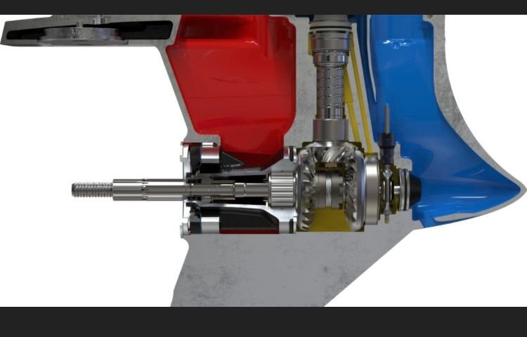

Originally Posted by JaayTeee
That picture looks to be of an outboard lower, it has a dog clutch in it
XR’s
can and do fail behind 525’s FWIW, if you don’t want to worry about it,
you need SCX uppers at the minimum
I checked again and this is still what Mercury is posting as being a Bravo XR. It may be the latest version from them. But still those gears/shafts won’t take that amount of hp for long. Been there done that and have rebuilt those drives many times on a previous boat with only 525 engines. That’s why I moved up to a SSM 6 drive package.

The XR is just the upper, the lower shown is a B3. The XR upper can be installed on the B1, B2 and B3. I had a XR on a B3
Zoom in on it, the sliding dog clutch is engaged in the reverse gear, also, it
has helical gears,bravo’s have straight cut gears
Yep
Furthermore Bravo 3?
Where's the counter-rotating setup?

Agree, no B3
