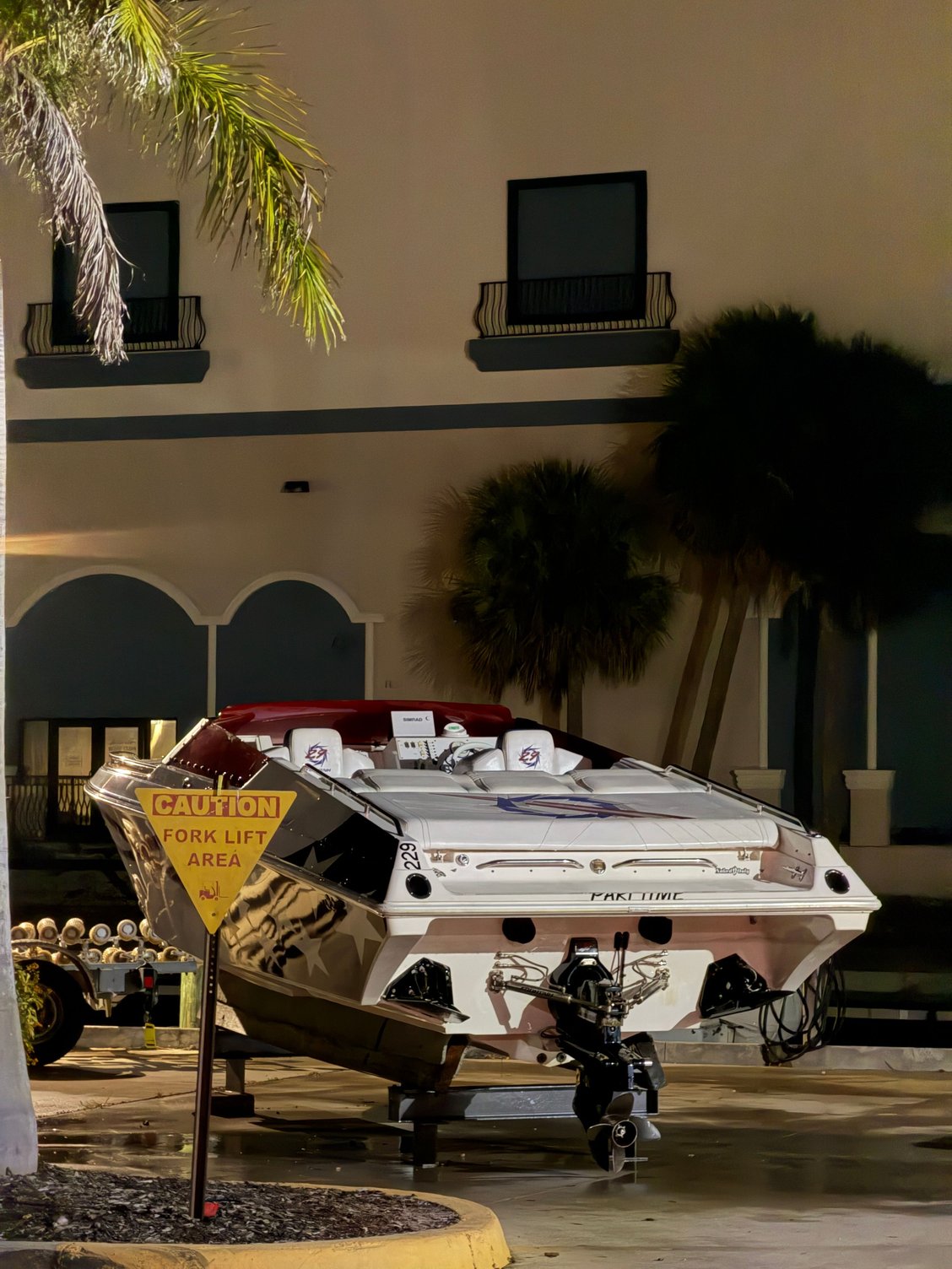

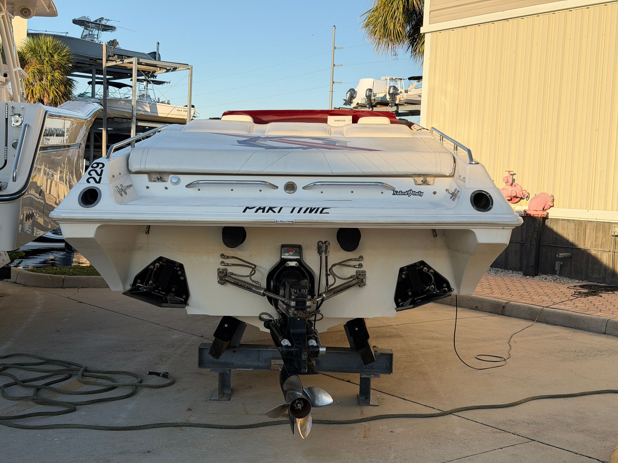

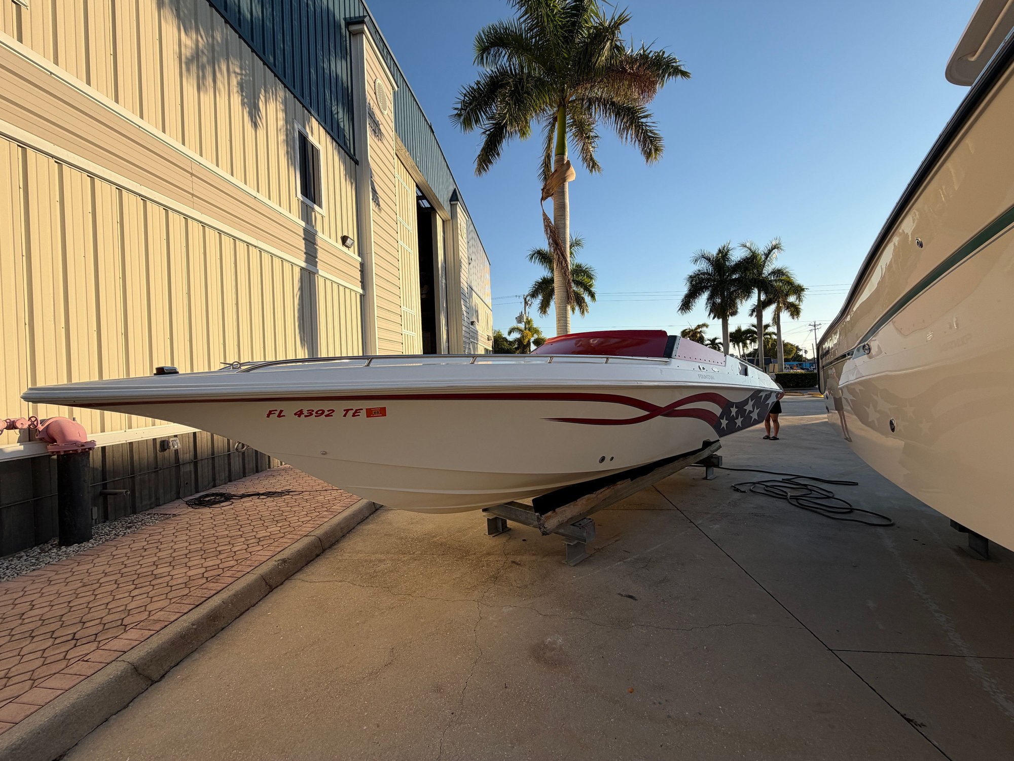

Hello everyone, I’m located in Cape Coral and I own a Fountain 29 Fever. Just wanted to introduce myself. I’m putting a lot of love into this boat right now and currently redoing all the upholstery to freshen it up and a full ceramic coating. I’m also thinking about swapping the engine for a 700 SCI. Any thoughts on that or recommendations for someone who does good work? At the moment I’m running a 500 EFI, but I’m definitely missing that Whipple sound, if you know what I mean 🙂

Nice Boat! 500 fine or beef up drives for 700hp good luck

If you do the 700SCI you will need to get a IMCO SCX at least.
There is not a Bravo around that will live behind that in a 29.
Look up Mike Morin on FB, he is in Cape Coral and his friend built a crazy 1000HP 29, should be able to help you with setup.
