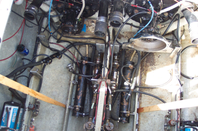

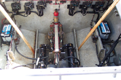

I have just finnished the transom work. Whew, what a chore...
I've started to do some of the things that were planned before the mulch project.
First, engine bay. New paint and diamond plate. Before pics...
Attached Thumbnails 10 Meter project-engine-bay-before-..bmp   10 Meter project-engine-fire-wall-..bmp

Am I missing something? What are all the pumps mounted on the bulkhead for? 2 for the drive trim (one each) and 2 for the tabs (one each). What are the other 2?

Brian,
Are your battery trays screwed down to the bottom of the boat or are they bolted thru the stringers?

Pach,
The outboard two are for hatch lifts. Fountain robbed the parts bin and used an old hydraulic cylinder that was originally an assist for 400 TRS cable steering. I know this because I had one that was leaking. Robert Toll (sp?) from Fountain gave me the scoop. They use the same pumps as k-plane/outdrive but lowered the pressure so as not to blow the seals out.
Dan,
They have two screws in the bottom of the tray and two bolts through the stringer.

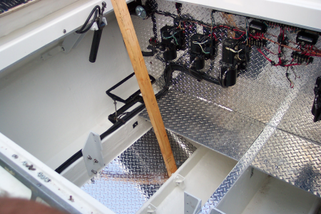

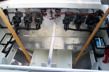

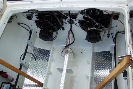

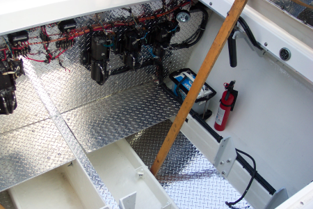

A little more finnish work, then ready for power.
What 'cha think?
Attached Thumbnails 10 Meter project-engine-redo-1.bmp   10 Meter project-engine-redo-2.bmp   10 Meter project-engine-redo-3.bmp

Last one for now...

looks good!!

Bryan looks pretty sweat, I will be sending you my boat to do over the off season
