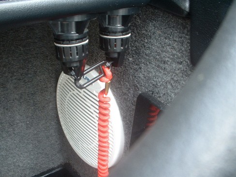

Here's what I have on my Formula.
Attached Thumbnails what r u running for a kill switch/tether set up-kill-switch.jpg

Those are the ones Cuda...probably the best out there. I have some new ones available(Mercury...of course) if anyones interested. Will sell for $45.00 each shipped. Ed
