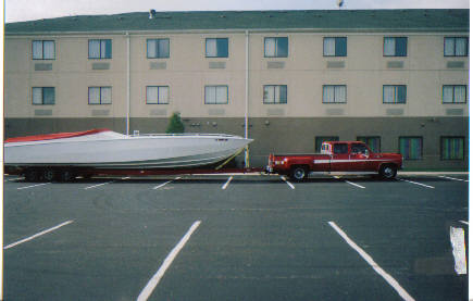

it is rated for 15k and welded with gussets. no problem at all. My truck is lowered, put air bags for additional weight, dont really need them and have 19.5 rims.
