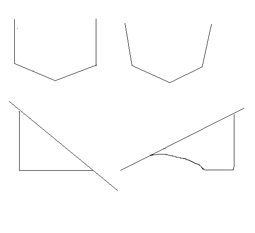

PARADOX 12-21-2007 12:40 PM
1 Attachment(s)
Originally Posted by VelocityMark (Post 2379753)
Before this thread makes a wrong turn, I just want to say thus far it has had some very good points brought out and I have enjoyed reading it. Welcome gramp but I have to ask what Velocity you are talking about that has a narrow beam? I have a 280 and the beam on it is 8'2", and the 39 that is so fast with the 700s in it has an 8'3" beam. A 38TS Top Gun has an 8' beam and a 38' fountain has an 8'6" beam, so I would say they are average if anything. Also I'm not sure what Paradox means by the stakes being designed to push the water away from the boat, my 280 has stakes like you drew for example A.
Both "V "hulls have a beam of 8'.. right, has a narrower surface.
Bottom right, allows more air, better lift, but harder when lands on wakes. geting the curve flatter in the rear and "out"... will tend to push the water out instead of straight back. The location of the curve will provide bow. mid or stern lift. I have an old INfinity, one of the last made with variable "rib" / strake design. one of the fastest 26' (with 454)and rides like a Apache in rough. (lol.. I can see all the Apache owners geting after me for this one )
Attachment 315797

PARADOX 12-21-2007 05:02 PM
Originally Posted by marylandmark (Post 2379941)
That pic on the bottom right with the arch looks like you have the shakes bro- get another drink before they get too bad!!
J/K- I know drawing with a mouse it hard! :drink:
No prob. :) But sorry Mark,, can't drink.. :mad:
Doctors order. Something with the pencrious chitt. It's shut down,, no cure.. no drinks..

monstaaa 12-22-2007 02:48 PM
i have done many repeat scenarios as far as set up.
typicly the c.g is responsible for step placement on a steped bottom(whether 1,2 or more steps) and optimal handling , speed and safety on any hull. then every thing else is applied, x-dimension, batteries , trim pumps, etc,,,, .
this is conducive for a thorough rig.
if it is done correctly then water conditions, fuel load, occupancy, power, etc,,, do not tremendously effect original characteristics of said boat.
proof of this is in the picture above.
