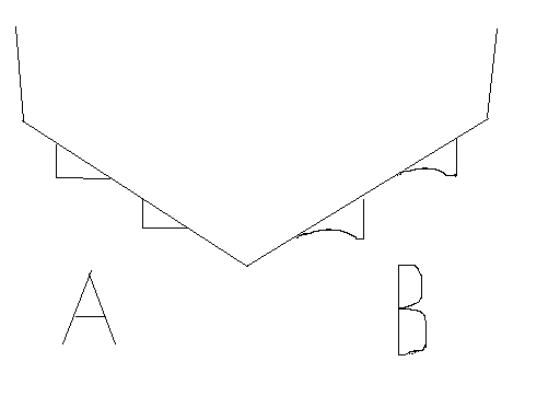

PARADOX 12-20-2007 06:46 PM
OK.. I'll put my .02 into this, having driven a step bottom in the late 60's.
First there are many different steps for different reasons, so let's not get into that. "V" bottoms can "ventilate" the hull if the ribs are "hyperbolic", In general, think of it this way. Steps are generally faster because they don't stick as much to the water as "V"s, The step reduces the "suction cup" effect, thus reduces drag, faster speed. Pads raise the boat, more speed. "V" generally cut through the waves. Deadrise is a major component in wave crushing and also speed.
Velosity's rakes and ribs are not true parallel to the sides or the bottom / keel, they divert some of the water to the outside so the boat stay more on top. (I don't know what the deadrise is) Less friction = speed. Less friction, harder to handle, squirmy. More weight=less speed, better in washing machine. Anyone figures out how to get "all" we want from one hull. Let me know.

PARADOX 12-20-2007 10:32 PM
1 Attachment(s)
Hard to draw with a mouse, sorry, but I think you got the idea.
"A" standar design, "B" hyperbolic and faster. more lift, more air, less friction.
Attachment 315752

I'm not an engineer but I had the Gancia dei Gancia and Ebel at my disposal and we ran them everyday we could both in the US and Italy up on the lake. So, we gained allot of experience with step-bottomed V hulls before anyone here in the US even played with them.
First, have you ever done the spoon under the faucet trick? Where you hold the backside of spoon against the downward flow of the water and the spoon is sucked into the water further not pushed away? That represents the rocker bottom on a V hull and how it will stick.
Now, to drive a V hull fast in the water (for open ocean racing, not on the bay or the lake for top speed) you need to have your drives tucked under or negative trim. The hulls rocker will naturally let the bow come up and your drives at negative should lift the rear and raise the whole boat, thus it goes fast.
Our big diesel race boats aside from being heavy all had fixed drives (now called Trimax) with a negative angle, much more so than you would run with an out-drive. That angle constantly pushed the bow down just like trying to get on plane with the drives tucked under.
What the steps did was create and very exaggerated rocker to set the stern back down and with all the weight they would stick like glue. The steps helped to break that tension that is demonstrated buy the spoon trick. So, we had a V hull with extreme rocker, extreme negative trim and steps to break tension. No one could ever catch us (when they ran good) if you remember.
Before someone asks about the wing – here what it did mostly. Our boats were narrow and always trimmed bow down because of the drives, they chine walked like crazy. The wing provided lift to help stop the chine walk. On Ebel the boat I ran 3 times a week, ever week, if you take off the wing you could not run more than 85-90 mph without Sh*tting your pants, you needed to throttle back constantly to get it under control. Wing on and it flew straight.
Again, don’t beat me up this was from Buzzi directly, I was an engine guy not a naval architect.
Why is a non-stepped hull just as fast some times - I think weight, balance and a straight bottom all add to it. Again - the SPOON trick - bottom is not straight, has hook, bad rocker it will actually suck down into the water. That's why when you blueprint the bottom, the area between the front of the engine bay and the transom is the most important.
