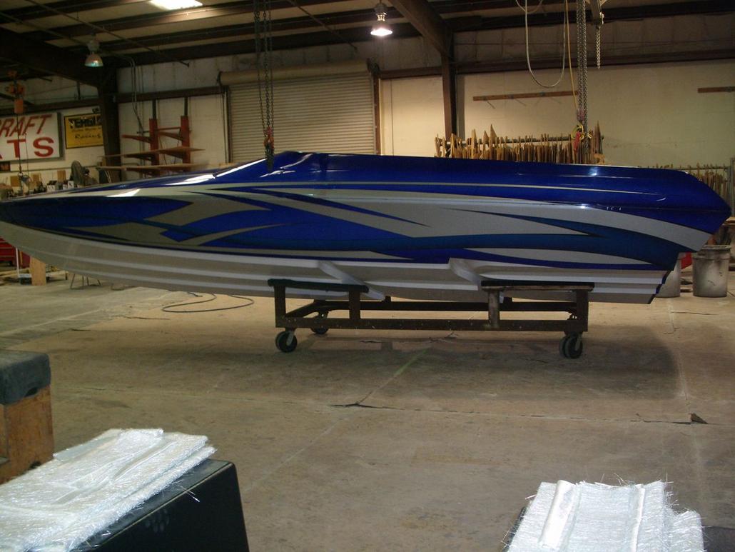

Here are the very first picts of the boat out of the mold today.

Boat looks sharp!
