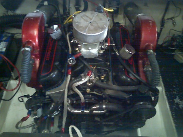

Second most important gauge on the dash. If you lose am impeller or suck up a bag or some grass you can kiss that motor good buy. The intake has 3 spots you can put the sender. Just above and to the right of the Tstat housing there is a plug that can be taken out.
