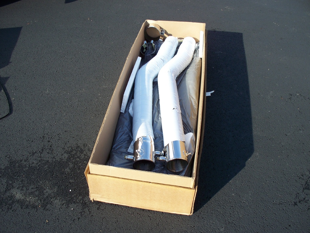

Here is my solution to the CMI leaking problems....Stellings! I decided to go with Stellings simply because I have had them on other boats without any problems. I got this current boat in April and ran it this past season with the CMI headers all the while keeping my fingers crossed and constantly draining them as a precaution. I didn't have any problems with the CMIs, but I didn't want to keep using them due to their track record.
This past fall I ordered a set of Stellings headers and tailpipes from Benfield's (Stellings dealer) to replace the CMIs. We have just started the install, but we have not finished it yet. We got all of the old stuff removed and the new headers on before it started raining, but we still need to install the new tailpipes. I'll post some pictures when it is finished.
