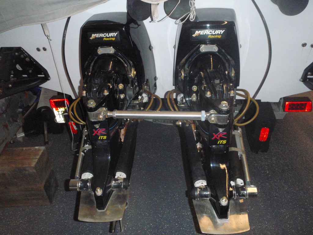

I have them on my boat and they have worked flawlessly for many years. When the engines are running there is enough pressure that the water doesn't go down the drains but as soon as you shut down, it just trickles all the trapped water right out so there is a huge reduction in the chance of reversion or leaks into the motors.
You can see them just above the waterline by the tabs.

I found a pic that shows the drain tube set up (ignore the dirty bilge!).
I am not sure of the size fittings as Ron Potter set it all up, but it is reduced to something smaller than the factory outlet.
I was skeptical about it at first but trusting Ron and after seeing it not bleed a drop (even on a hose), I was convinced.
Once the engines are shut off, it takes a a minute or two before anything starts dripping out of them but it definitely works.
