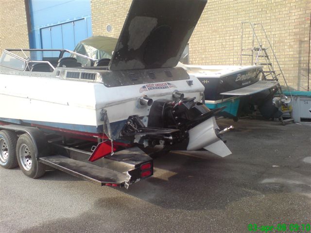

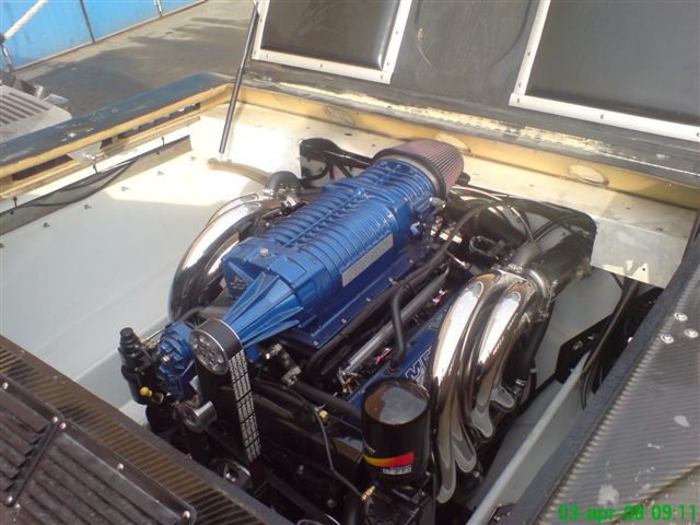

In Sweden we don't need a fancy g*yboat for a NXT-package... hahahaha.
I think the owner loves his boat pretty much...
30ft Great american concept's
//Mange

Yeep it's paid for. It's a doctor who owns it. Had a 510ci SC 750hp before but just wanted any newer engine and drive. He loves to run the boat so I think thats the main thing here. We do not talk about a pink kozzie runner here...
